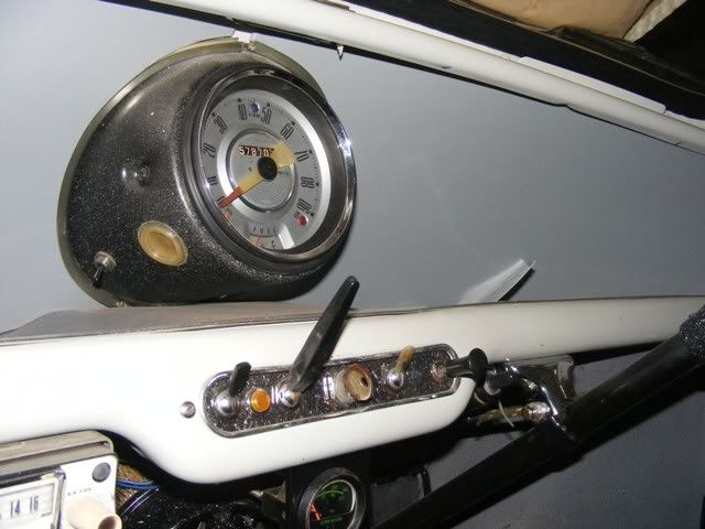

Can someone please be able to tell me how far the Vandals have gone with this car,. As I can see a white binnacle and switch panel. Why I asked this question, is that our 61 (Elmore) came with (See picture). Which we through cardboard came before plastic. As Mary Loo came with neither which should it be.

Its getting a bit early for my expertise, but the switch panel was always metal. The early ones were flat, i.e. without pressings around the choke and heater knob, but I don't know when that finished.
The early cars did use a paper mache or pressed cardboard binnacle around the speedo, I think until some time in 1960. My January '61 Traveller has a plastic one.
I'm pretty certain the black flecky black paint on yours is wrong, they should be painted white, about the colour of the plastic ones. The parts books says Old English White, but it says that about lots of white parts.
