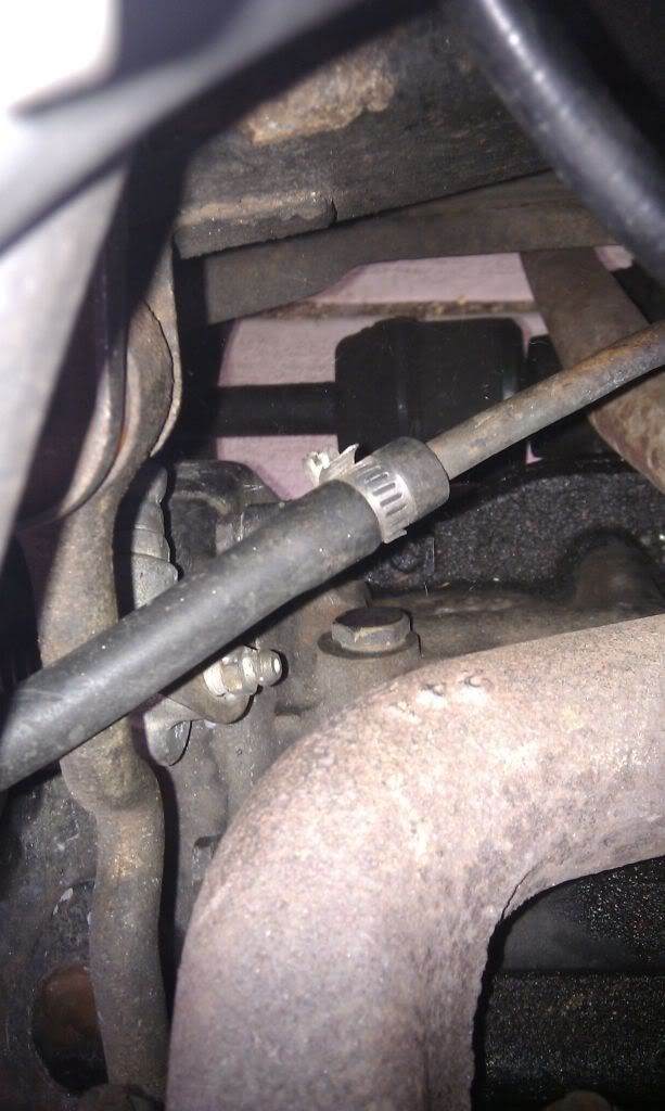

The plug in the back of the block to drain the coolant...where is it? Is it this one (looking between the exhaust manifold and the host clamp)?
'77 Leyland Mini Van
PostPosted: Tue Nov 08, 2011 2:53 pm
Posts: 39757
Yes that's it but don't be surprised if nothing comes out.
The water jacket silts up with rust etc back there, and nobody ever takes that plug out.. :lol:
Once upon a time (early 850, Minor 1000 etc) there was a tap (petcock) on there, which made sense then when people drained their blocks out.

Yes , thats the one , they sometimes have a copper washer which does,nt like being squished , like I said run the motor to get it up to temp but not to hot , it,s a bugger of a thing to muck around with , just be careful you don,t burn yourself , I,ve done it three times on the "Snail" and every time there was lots of %$*&^ and ^(*%$ plus a couple of &^%$ and *&#% thrown in as well
Get some thicker wire about 4 or 5mm and make an open L shape so you can poke it in and see it you can get a flow happening , it you can happy days you can proceed with a proper flush , if you can,t you just to have persist with poking till you can get some crap out ( sounds a bit wrong )
