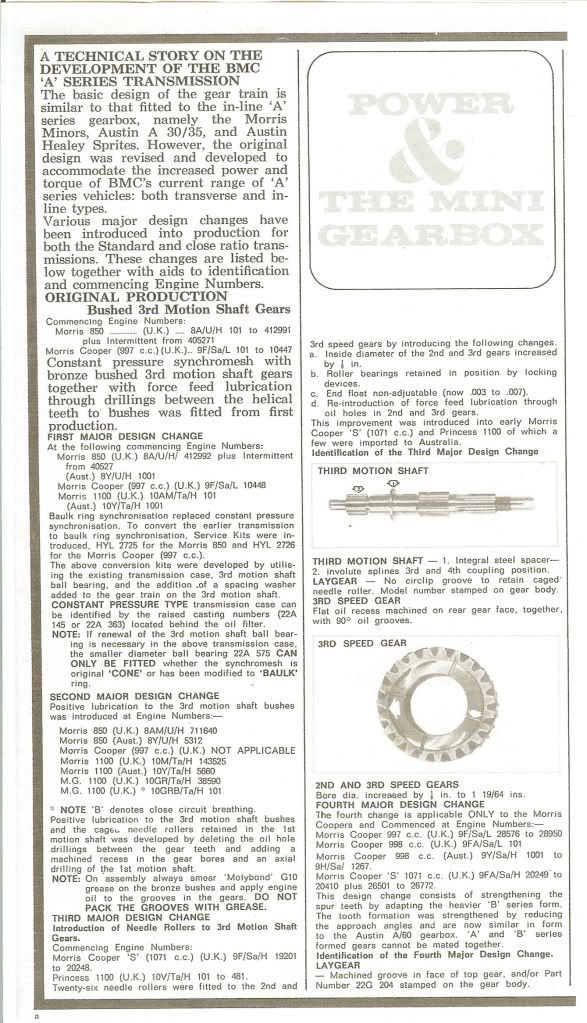

For those wanting more detail on the developmental changes made to the Mini gearbox up to 1965 the following article from the late 1965 issue of BMC's Partner Magazine might be of interest.
