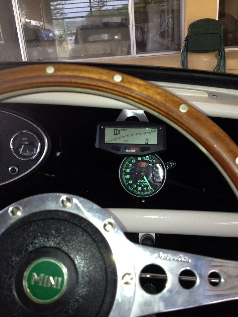

As promised, heres a photo of my set up.
I wired the brown and red wires to the ignition, black to earth. The yellow wire to the -ve coil terminal. I removed the blue wire (fuel sender) as I don't need it.

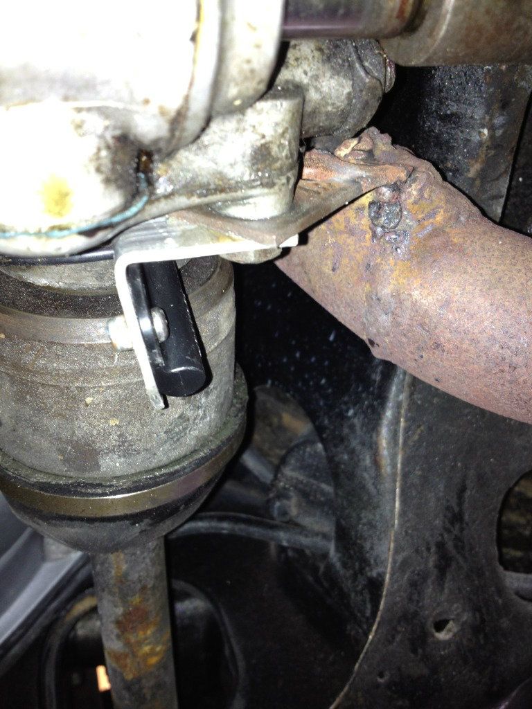

Here's my placement of the magnet sensor
I epoxied the magnet to the metal part of the cv thingy and made up a 90 degree angle out of 1.5mm aluminium plate I got from bunnings for $2.40.
So far the RPM and speedo seems pretty good. I set the rpm at the .5 setting and the speedo dia at 1546 but haven't checked it with the gps yet. Will post again once I verify the correct figures.

Are both those gauges part of the set up? Or just the speedo?
Seems to be conflicting info about whether or not the drive adapter fits?
PostPosted: Sun Jun 03, 2012 8:35 pm
Posts: 806
Location: Woody Point 4019
I originally bought the Saas tacho but it jumps around a bit, and randomly resets itself to a different colour every now and then. Ive left it there as a cross reference whilst i was sorting out the acewell unit.
The Acewell has a bar tacho and digital numeric rom readout as well as speedo. You can configure it to display elapsed time, odometer and a few other things. Although it is small, I can easily see the info where I have installed it. I bent a piece of aluminum bar and made a bracket to hold it. You can see the ss mounting bolts next to the wndscreen vent if you lok carefully.
The screw on speedo adaptor i bought was the one for a honda and ktm. It does not fit tightly enough into the pinion drive to be accurate.
