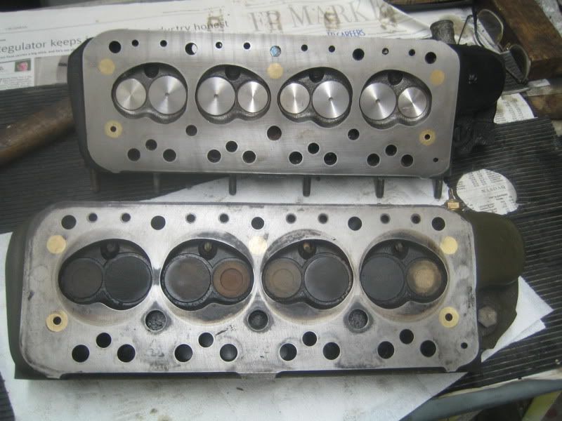

OUCH...on preparing the rebuild, cleanup of the head revealed a crack between #3 and #4 chambers (mirroring the crack in the block)...
Fortunately, I had a built head on the parts shelf so with a look and little cleanup, the "new" head joined the rebuild.

Took the cracked block into the machine shop today. Will take liners out of #3 and #4 (both liners are heat distorted), check repairability of crack with stitch welding.
If repairable, will "stitch", bore and install 0.030" thicker liners and take back to standard 1275 bore and hone all 4 cylinders. Also chemically clean, drill and tap for oilway plugs, new cam bearings, freeze/expansion plugs etc.
Head will go in tomorrow re crack between #3 and #4 chambers. Will be interesting to see if it can be repaired as crack can be seen to be 1/8" deep. Disassembled head today and all valves/seats and iron guides are good, stem seals soft/flexible...not many miles or abuse indicated.

Head is SCRAP - magnaflux today revealed very fine but deep crack down through the shared #4 intake/exhaust seat area in addition to the crack between chambers #3 & #4.
