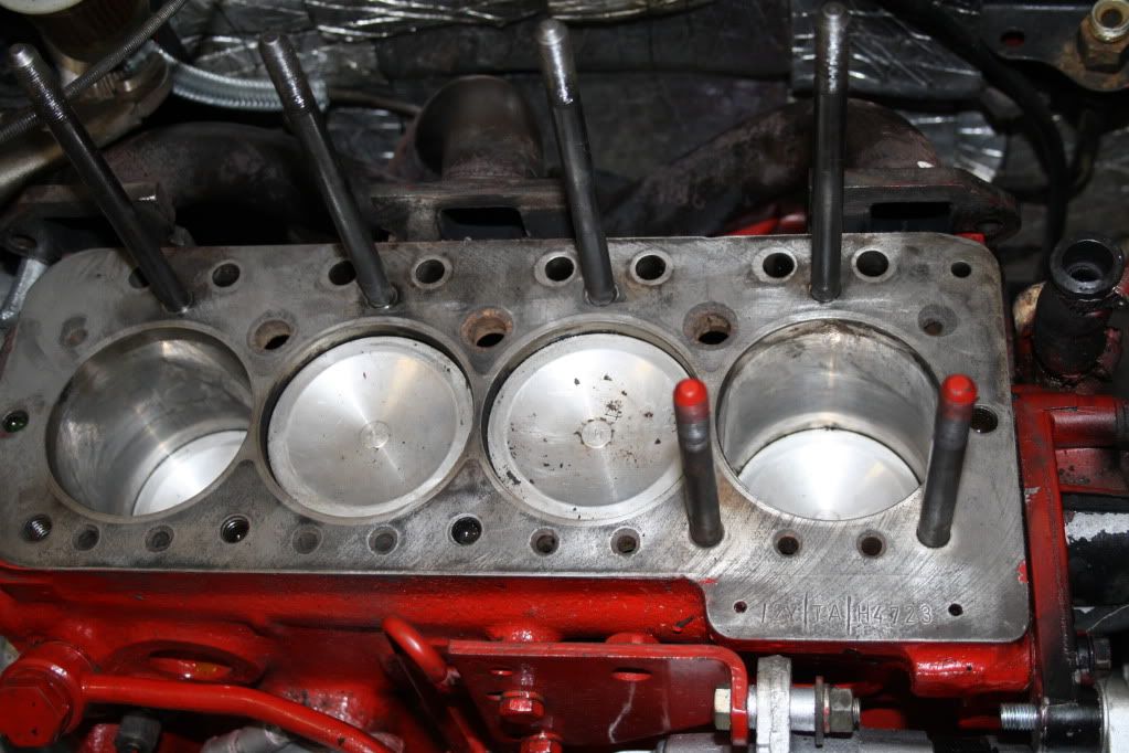

Yeah ive screwed up pretty bad. Not sure if its of any help but i did take photo's of the pistons before i put the head on. They are dish but not sure if it is standard dish or not.
:) Nah, haven't screwed up yet... haven't screwed up till you assemble it and find out that you should have checked all these things before hand.
Doesn't matter if your pistons are standard or not, you should stilll measure them the same way we got you to with your head, using a CD, like the doc suggested, or a sheet of acrylic with two holes like I do and a burette or syringe

So remove the head,Measure the compression chambers and the piston dish and work out the compression ratio ? Thats my first step? then modify if the ratio is too high?

PostPosted: Sat Aug 25, 2012 8:40 pm
You could do it the way motorbikes do, with head on, it's easier. More accurate too.
1. Face car uphill.
2. Remove the spark plugs.
3. Position #1 or #4 piston at TDC, compression stroke (both rockers loose), TDC timing marks in line.
4. Fill a syringe with light oil of some sort. I suggest ATF, it's thin and cheap.
5. Fill the cylinder through the plug hole until ~1/2 way up the threads.
6. Read off the amount you put in, this is the total CV from my formula above. Calculate the C/R, `displacement' being engine size/4.
7. Put a bunch of rags in front of the motor, crank for a few secs with plugs out. There's only about 36cc or so in there, not too much mess.
8. Refit plugs, hose any ATF off the front of car and you are good to go. :wink:
