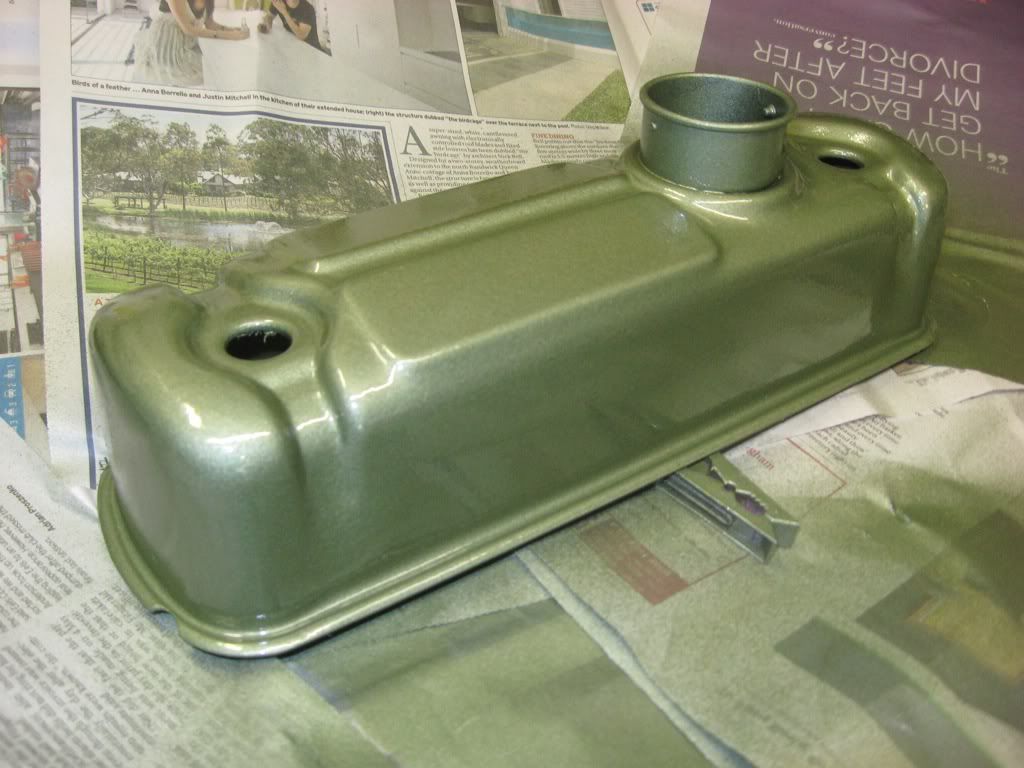

I did 2 motors with Mini King's Cooper S engine enamel 6 or 7 years ago.
One I brushed straight on.
The other I etch primed then sprayed.
The 1st one (mine) is still fine, the other one (Barney) had poor adhesion, paint started coming off a year or so later.
So these days, I don't use etch primer under it.....

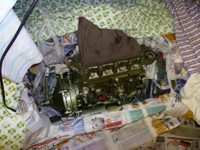

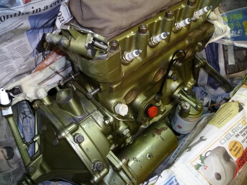

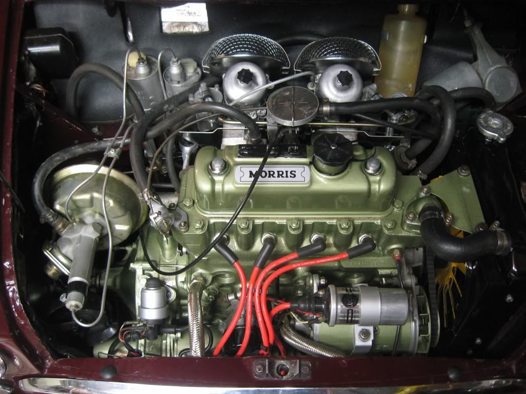

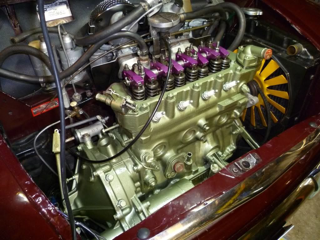

Yeah I did my engine in situ. I just cleaned with degreaser then I think I used either disc brake cleaner or wax an grease remover. I removed as much of engine as I could eg generator, dissy,
Like dr mini I used mini king met green and no undercoating. The old paint was patchy and I just left what was still well adhered of the old paint.
I used prevel mini sprayer
Still looks good couple of years on.
Before......
After......
