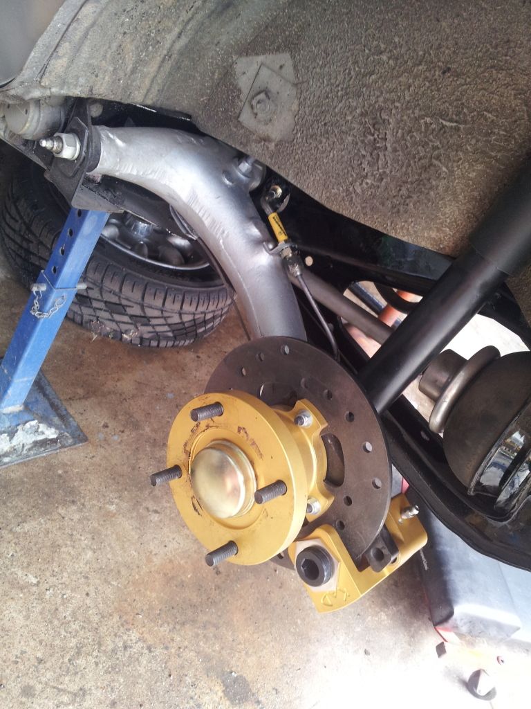

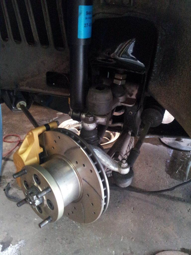

PostPosted: Sun Dec 09, 2012 3:04 pm
like these?

Geeez that looks nice Matt!!!

Shane, those brakes were just some crappy old things we had laying around here :-) i just figured we could use them up to get them out of the way :-)
& Imbm... the bump stops were simply a matter of -> We had them sitting here & didn`t have any dry ones in stock at the time :-)
& just for the record,,, i`m not such a big fan of vented brakes on road minis,,, nor am i fond of heavy 4-pot things... so my ideal for road & occasional track use would be 2-pot alloy calipers on solid large diam rotors... but it all really depends on your budget & your wheel size... or your will/need to pretend how awesome your brakes would be if you actually used them to their potential ;-) instead of just pub bragging rights :-)
