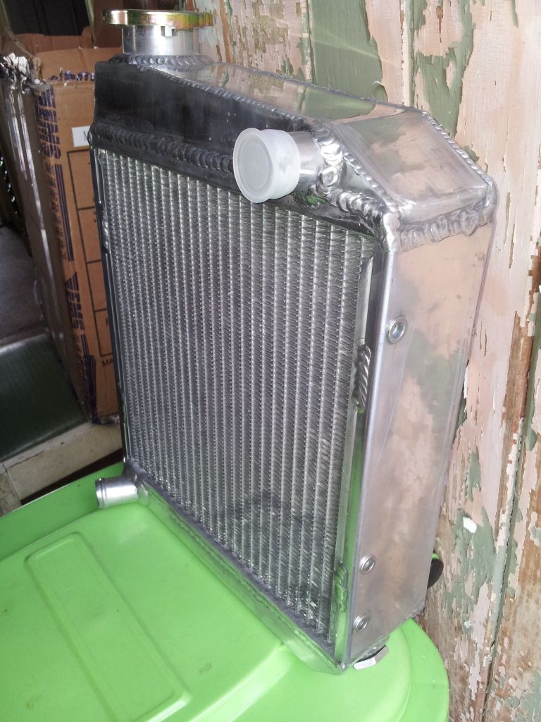

& i must say that `m pretty happy with the quality of alloy radiator that the Chinese are producing these days,,,, the cores are really good quallity, the welds are top notch, the material is really really good ,,, we`ve tested them for years & years & years now & on some pretty wild & very fast engines i might add,,,, & the price??? well you just can`t buy better so why not fit a chinese alloy rad??? i don`t/havn`t seen any problem with them at all.
i`ve literally fitted hundreds of the things now (not joking) & not one has given us any trouble at all.
here`s my special 3" thick, sooper-dooper 2-core jobby going onto one of my own personal engines :-) -->
gotta love a monster radiator for a monster engine hey??? :-) ;-) :-)

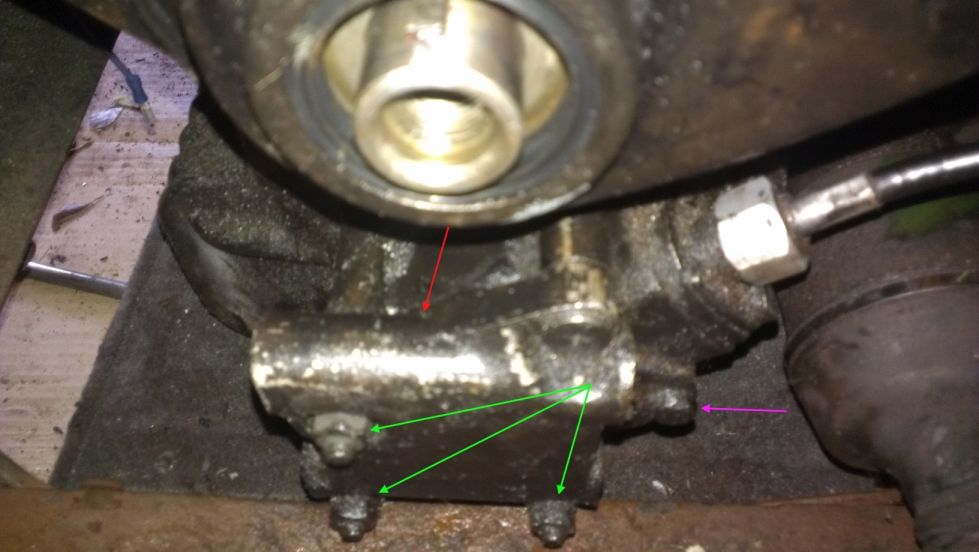

Hrm...replaced the timing chain finally (single row) yesterday. I dropped a flat washer down the little slot that is above where the speedo cable goes into the gearbox, however, whilst refitting the timing cover. Is this a problem or will it just be sitting in the sump, hopefully getting close to the plug as the oil moves around?

I realise now that my description of my disappearing washer situation was probably not the most accurate.
I have had trouble finding out what the little gap in question (red arrow) is there for in the manuals. From it's location, I assume it leads directly to the gear box. If this is the case then I assume the washer is sitting in there at the moment.
So my question is: Can I remove this little housing simply by removing the three nuts (green arrows) below and hope to find my little friend?
Or maybe this little gap doesn't lead anywhere bad? :)

If you have another washer you can save yourself the hassle and ignore the one you lost - behind the mount you've arrowed is..... nothing :lol: There's just a little gap between it and the end of the gearbox (speedo gears from memory)... so no does not lead to the sump...
