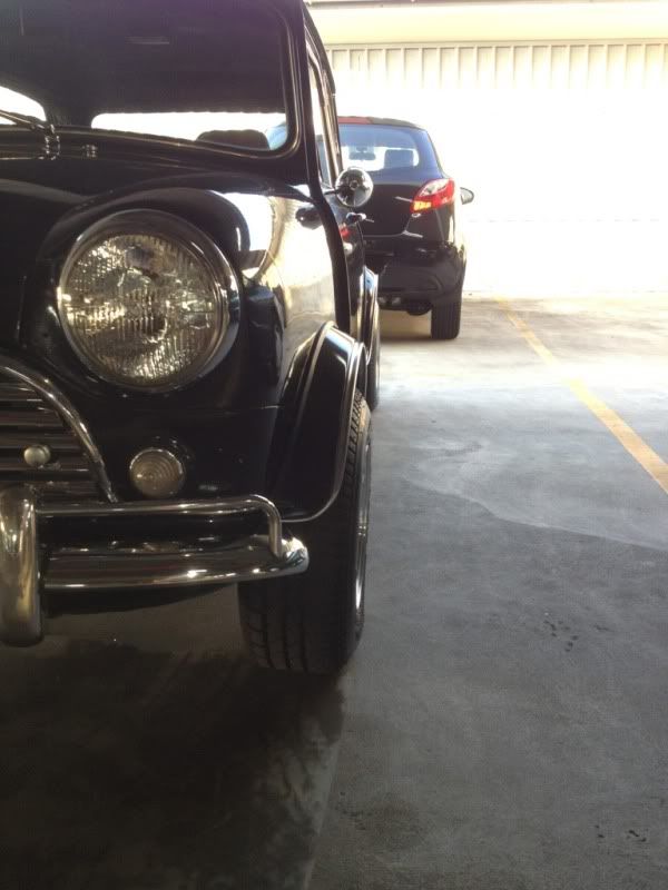

Heres mine 10 x6" revo's with innocent plastic arches yoko A008's

Be careful with the sixes, everything except the widest of arches will not be able to cover the tyres fully. They look porn however.
Any ideas how far?
Just picked up a set of fibre group 5 arches for a rainy day. Wondering how wide I'll have to go to fill them
Anybody? Anybody at all know actually how far out the 5" and 6" mambas sit?
My 6's measure 32cm from the inner guard by the shocky to the outside of the tyre.

This is the measurement I tried to get when selecting my wheels, but was given a bum steer. So here is the measurement you are after (taken five minutes ago) for 10x6 Mamba's from Midland Wheels.
From the face of the disc, or the stepped drum, which the rim butts up against, to the out edge of the wheel rim is 100mm.
Lowered they will rub the front of the guard. Mine sits high and has just touched the front of the flare backing on standard type oringinal flares.
Going by mine you would need at least 80mm wide flares.
