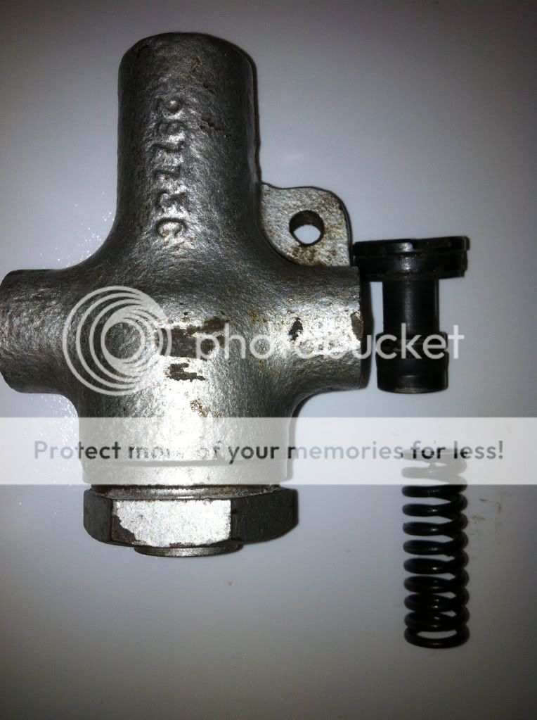

Ok got mine on the bench.
1st one is a 3231233C off a 1970 MKII S.
It's spring has much thicker coils and is noticeably harder to compress.
No rings on it though, the top edge is raised where other one is not.
2nd unit is : 93773C and its spring appears longer with thinner coils and easier to compress than the other
Just trying to determine which one I should be using, correct to the car and to do it job correctly.
Now with 2 extra ports!

Do you think the spring looks correct ?
That seems to be the important part in all of it.
When the car was last going in 1998, the rear brakes used to lock, particularly in the wet, so I'm just trying to match all the correct parts to stop this.
Over the years as things have been changed I think it ended up with the wrong rear wheel cylinders, and the internals of the limiting valve had also become clogged up and corroded.
I guess in my thinking , If I can work out the correct spring, then that is one more thing put back how it was designed.
Really appreciate every bodies input. Thanks.
