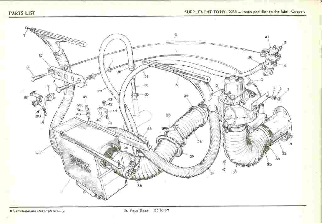

PostPosted: Fri Mar 29, 2013 1:45 pm
Posts: 6750
I've posted this exploded diagram in a previous thread but thought it easiest to repeat it here. According to the part descriptions clamp #33 that secures the hose to the intake tube is 4 1/4" diameter, and clamp #34 that secures the smaller hose to the blower is 3 1/2" diameter.
