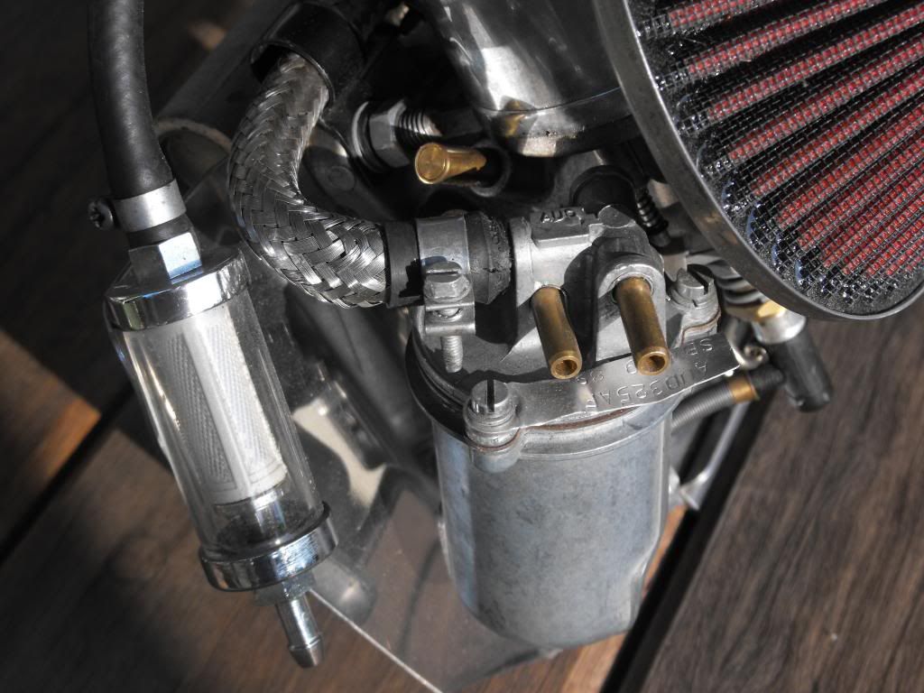

I just had another look at mine to check the spacers for you , it doesn't have any :shock: :lol: , should of known that as i had the manifold off a while back so i could tap another vac port in it .
As per the top on your r/h carby , mine has the 2 extra pipes as well , what are these actually for , any idea ?
PostPosted: Sun Dec 01, 2013 8:17 am
One feeds in from the fuel tanks to share out through the hose, and the other is a vent I think.

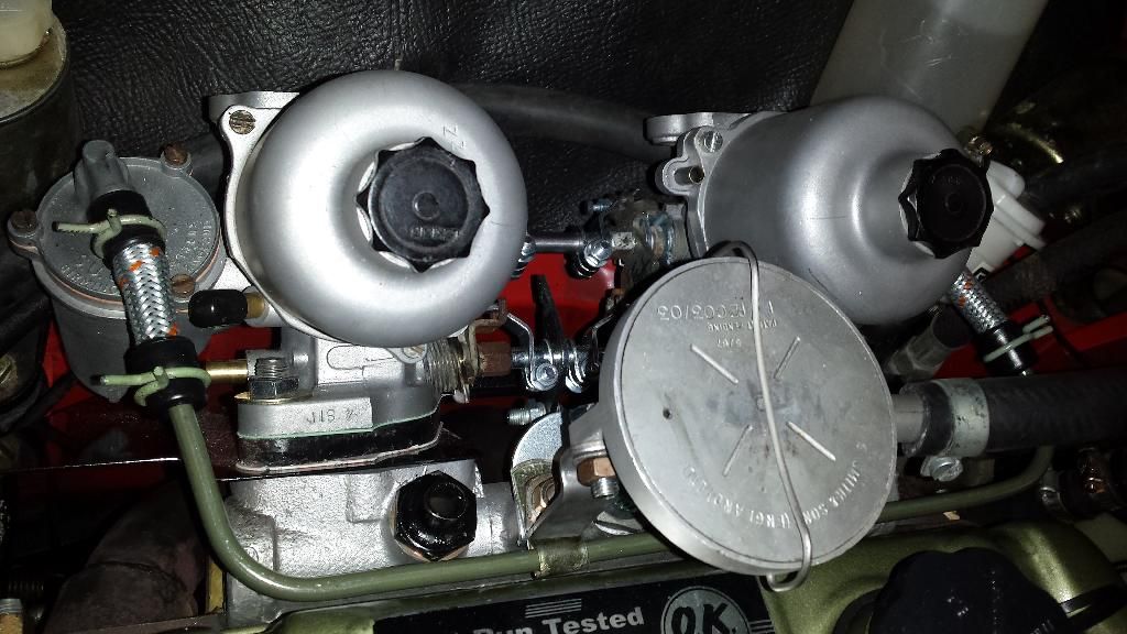

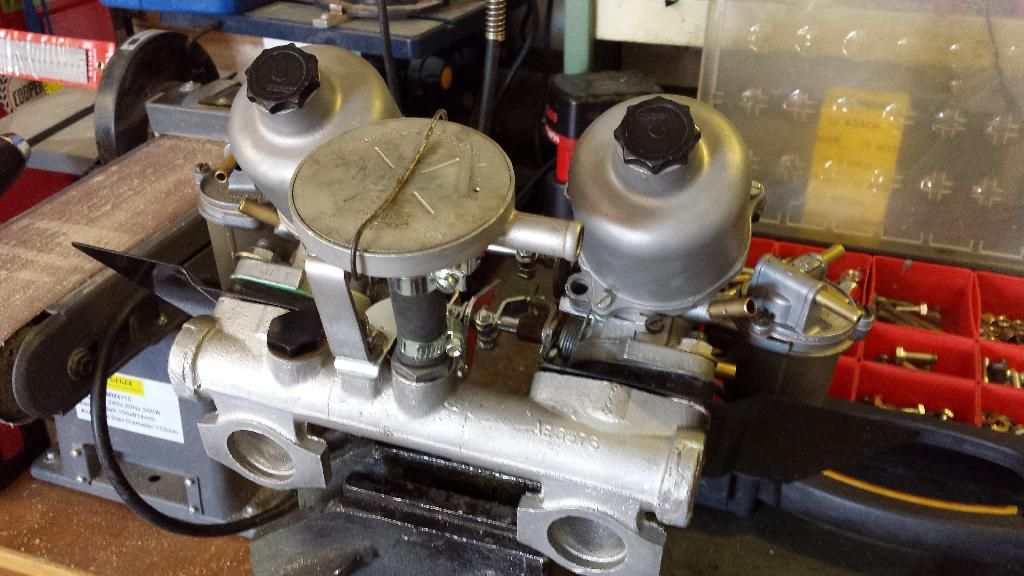

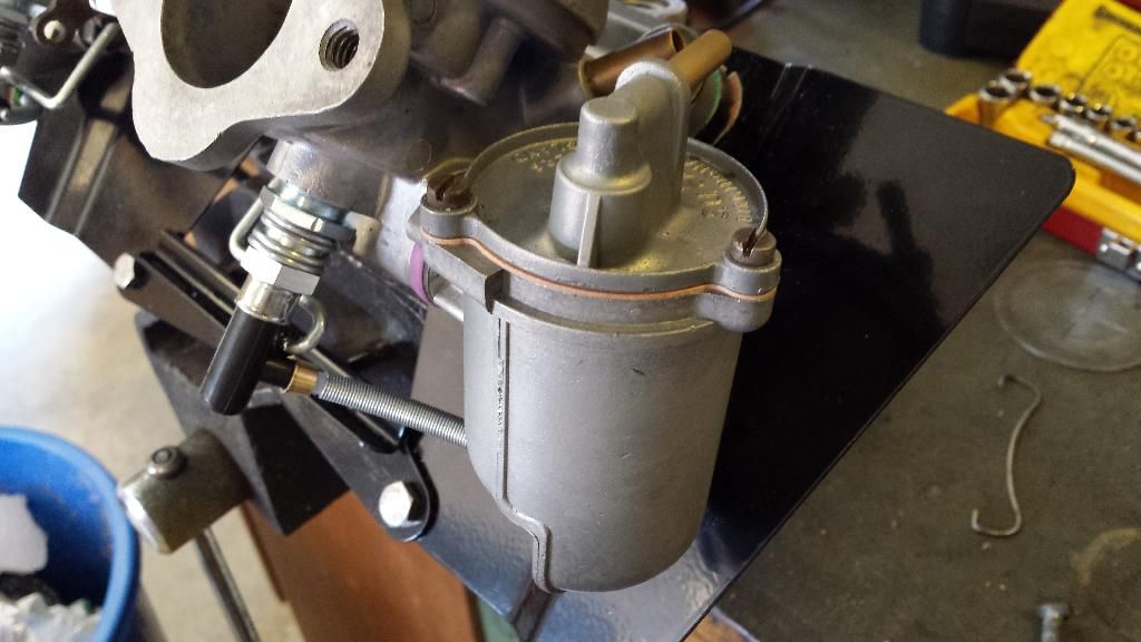

I picked up the float bowl from Morris 1100 yesterday, thanks Michael.
I gave it the treatment in te glass bead blaster and after a good clean fitted it onto the carburetor.
The carbs have a brass emissions port to draw in crankcase fumes, but I have elected to keep the PCV fitted for no reason other than aesthetics. I think they look good in there.... I will get a couple of small rubber caps for the emmissions ports on the SUs.
Nothing to do now but to wait for my Manifold gasket to arrive...I forgot to order one earlier...

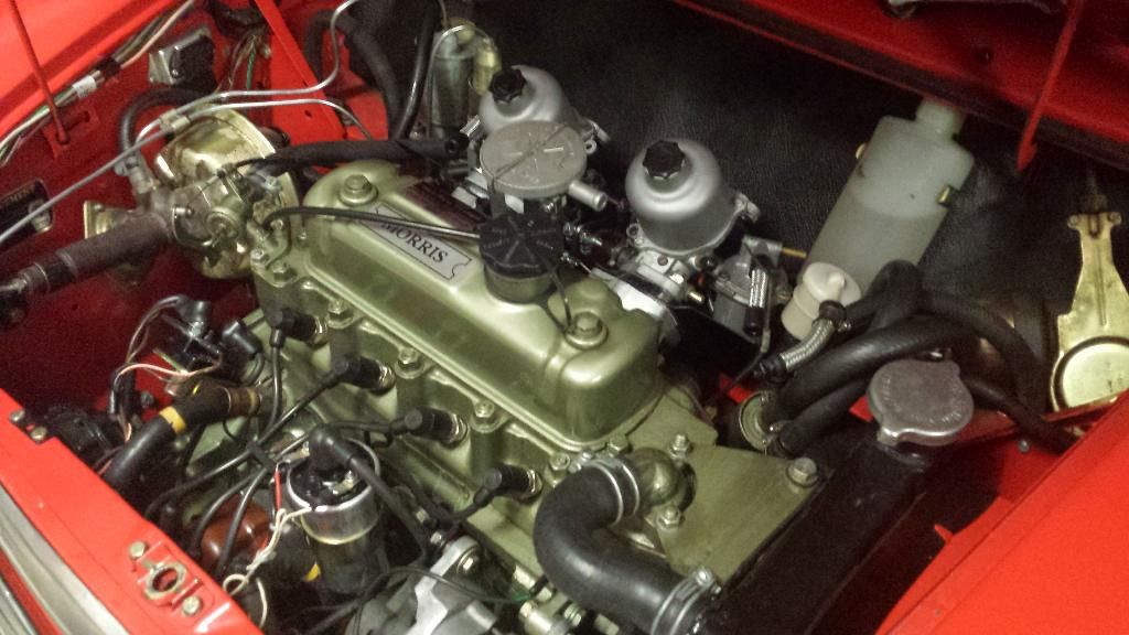

On their way now. I decided now that the rellies have shuffled on I might give the 1.5s a go on the car.
I'm short of a piece of 1/4" bundy tube to make a fuel cross connect with, so will finish them off tomorrow.
I've picked up a pair of cone filters for the moment until I get around to modifying the trashed twin SU airbox I have here.

Damn that engine bay looks smick mick. Bloody lovely to look at.

Thanks Boo, everyone has their thing. I like engine bays...

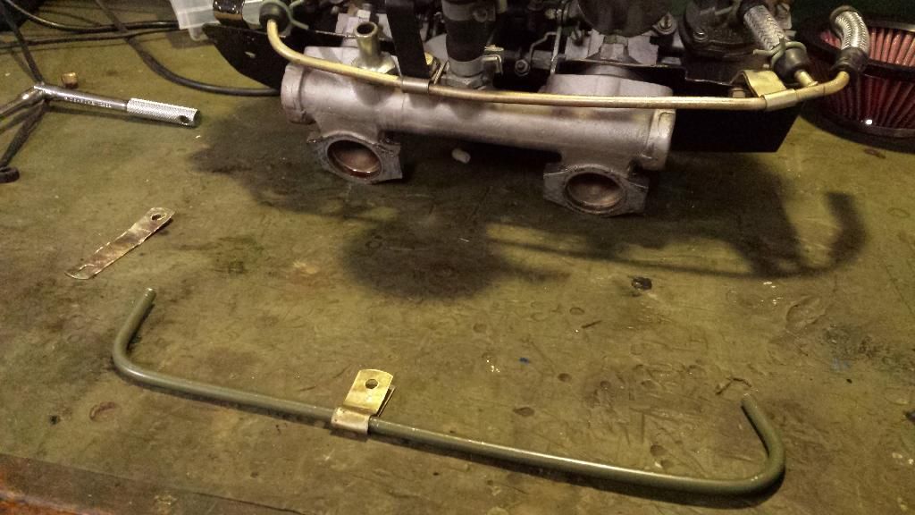

I've completed the fit out today with the creation of a fuel cross feed. I picked up a meter of 3/16 (inside diameter, 1/4 outside) bundy tube from ABS Brakes. Unfortunately it is the green plated variety, but I don't mind that much. I bent it up with the aid of a pipe bender, and fashioned a anti vibration saddle from some flat ribbon I have handy in the shed.
The pipe fitted up nicely, and nothing leaked once the pump was started.
I used a pair of Colortunes to set the carburetor mixtures, this didn't take very long at all. The carbs were first matched for airflow at idle, then the mixtures were matched. I revisited the idle settings, and then the mixtures as well. Once I was happy, the carb linkages were adjusted and locked in place, and that was about it. The idle beat is perfect, like there was no change. I took it for a test drive this evening up the mountain range out the back of my place, and it sure is a very sweet setup. I'm very pleased with the results. I have a standing mile up the mountain range I like to race up, its pretty steep but smooth, so no outrageous speeds, but I know how the car behaves and everything felt much stronger. I love the new twins.

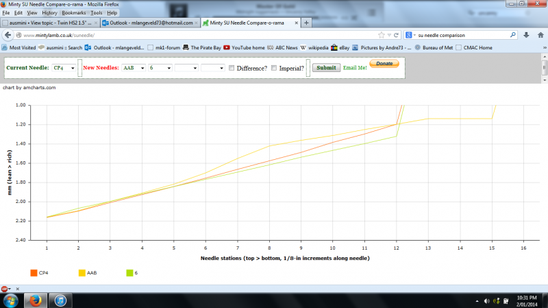

By the way , what needles are you running ? My carbs have AAB needles in them .
PostPosted: Thu Jan 02, 2014 9:27 pm
I asked Doug (Winnabbee) what needles were fitted to the Police Coopers and fitted those. They're static CP4 needles.
I will have a look around and play with a few other needles once I have an idea of how these are behaving. How did you arrive at the AAB needles?

I had CP4 needles in Barney's twin HS4s for a bit, but got a flatter A/F ratio curve using #6 instead. Filters were Ramflos with Unifilter foam.
PostPosted: Thu Jan 02, 2014 9:31 pm
The #6 looks just that little bit leaner across the range. What was Barney's specs Doc?
