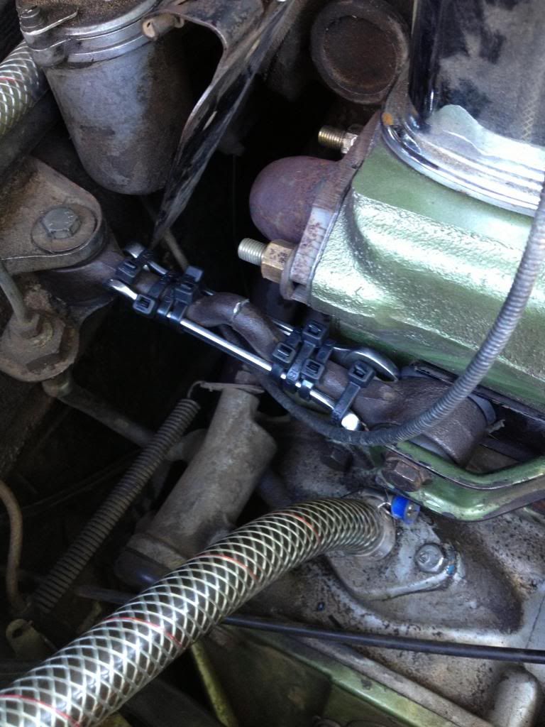

Cable tied a splint to one of the engine steadies. Covered well over 1000k's including a couple of laps around Bathurst and some fun twisty roads. Even after picking up a new one I kept using it until I was bored waiting for lunch and decided to change it on the side of the road.
Knowing my luck they would be the two spanners I needed the most that I used :shock: and would curse every time I couldn't find them.......
