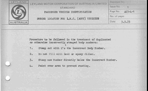

MrFail wrote:
Mine had something similar. But the higher number was ground back .
Any incorrect numbers were meant to be X'ed out, not ground back or hidden. That's not to say it never happened.
