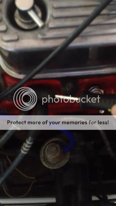

tappets reset and still the same issue??????
number 3 spark. was same at plug end as well so spark at plug
