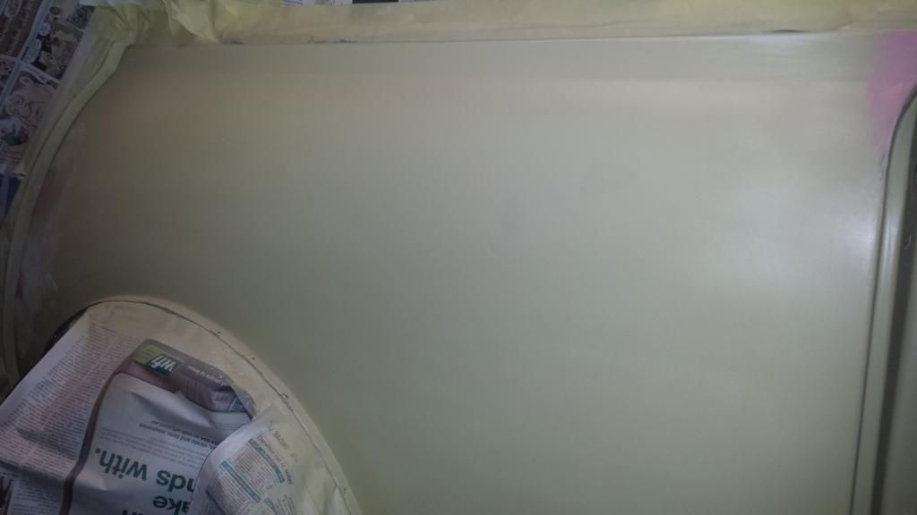

Well I left the pyro bottle in the cupboard, and nearly dragged out a can of freeze spray as well, but in the end I went back to good old fashioned dollies and pushed them out by hand.
It looks pretty good now. There's a light skim of blade putty, and its come out quite nicely.
PostPosted: Sun Jun 01, 2014 8:47 pm
Looks good Mick. I was told years ago that most Oz Minis got bog put in that panel down near the bottom, during production.

Well done with the fix, heat shrink is rather easy with the right tools.
Oxy/acetylene torch and Garden Hose trigger gun.
First make sure the panel is not coated with tar or the back has trim on it as it could catch alight.
I use a no10 tip on the oxy, a stand off of 10mm with neutral flame and heat the panel till a 20mm wide disk of panel is glowing red. Then blast it with water from the garden hose (make sure the oxy is out the way). Hold one gun in each hand or have a helper standing by. You can use several spots however try not to over lap them.
The heat expands the thickness of the panel at the spot and when cooled pulls in the metal around it at a greater rate. You can repeat this process across the panel to pull it tight. Near edges I use smaller spots and more of them. Something like your panel would have only used one spot.
This process (with a 15 tip) is also great for trailers with a stretched tub and truck sides (not aluminum ones though) actually it's so easy to be fun. The results are really impressive once all the spots have been sanded clean and painted/coated
