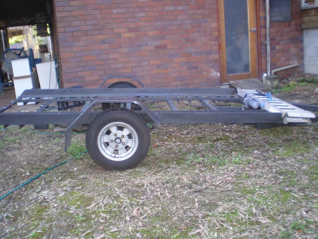

I've been through all of this as well. I started with a very light 3mx1.5 that I sold to someone on here. Brilliant trailer, towed well and you hardly knew it was behind you. Was bare bones and weighed less than 300kg on single axle. Downside, nowhere to store anything. You cannot possibly make a trailer that will tow a mini and stay under 750kg, but I would love to be corrected if thats possible.
I think this is Greg's old trailer, I kept a photo as it looked light weight which is great!
 Post subject: Re: Car trailers
PostPosted: Sun Aug 17, 2014 9:23 pm
Posts: 1478
Location: queensland
Thats the old girl,
Great trailer.
G.
