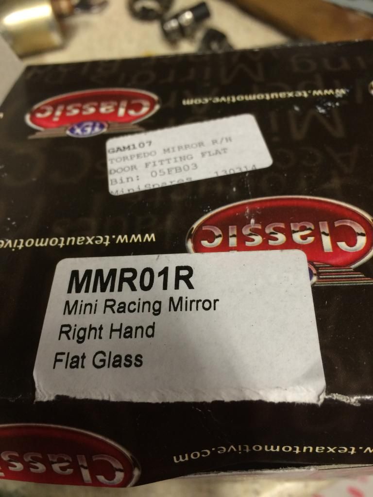

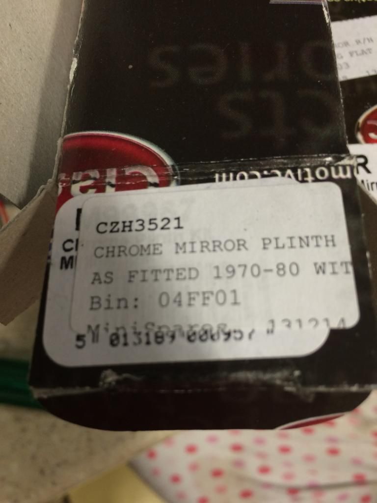

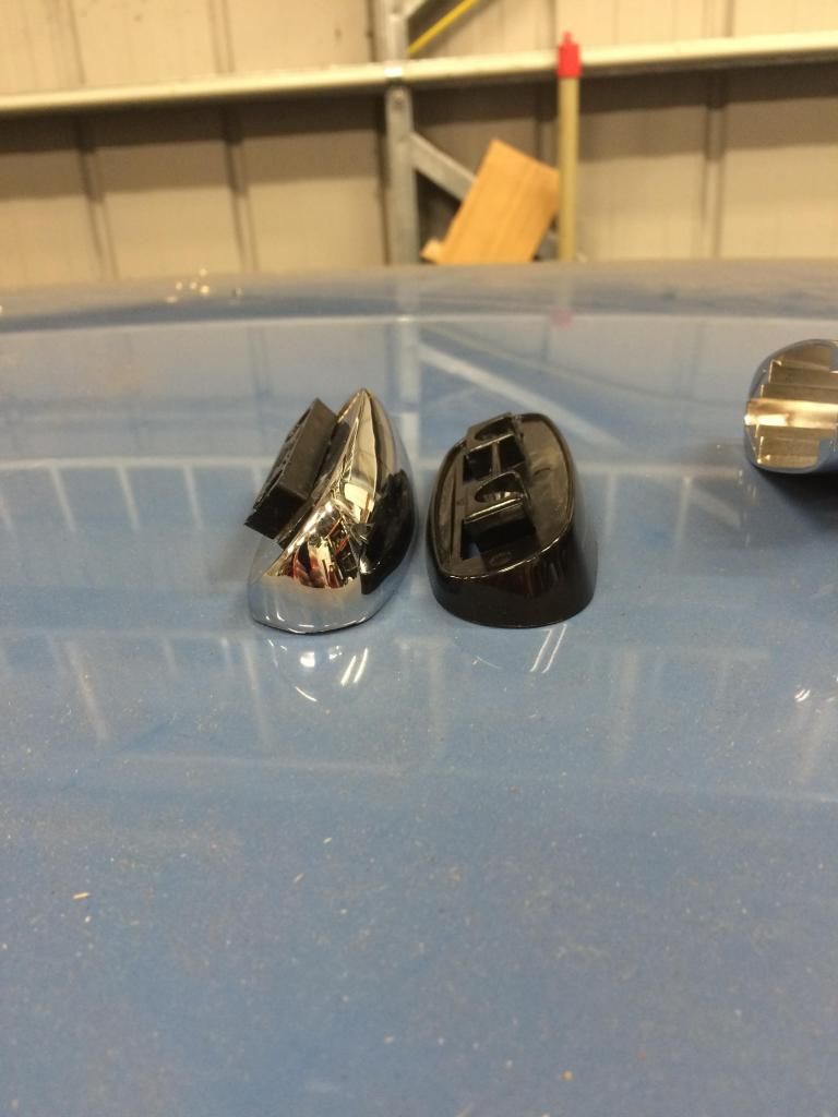

I have a pair of those GAM107 & GAM108 mirrors. They came with the black plastic angled spacers or flat gasket bases.
Then I read the Doc saying the plastic melts and the mirror falls off and you should option them up with the chrome bases instead.
So... In today's MiniSpares UK delivery was a pair of chrome spacers. BUT, they are a different base angle and they still have a plastic inside them so maybe that will melt anyway??
Here are some pics of the parts:
Maybe I ordered the wrong chrome bases but they are no good as the mirror will be angled in more when really in use and with the chrome base it will clash with the glass.

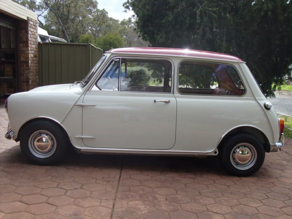

This mini of mine is 47 years old and has never had any extra holes put in for mirrors, flares, radio antenna or anything else.
Last thing I would do to it is drill more.
Just my thoughts.

Nope, the bit of plastic that's mounted to the chrome base is fine. It's pretty rigid. Unlike the standard rubbish plastic mount that can't stand Aussie heat and sun. It doesn't melt, it just warps then the screw won't hold the mirror to it.

I tried these too, the actual mirror is fine but the plastic mount is rubbish. I fitted mine and came out next morning to find one lying on the workshop floor. The plastic was so crappy you could pick it away with you finger nail. I have these ATM, still on there, haven't fell off yet.

I've got bullets on both sides. You can definitely get convex glass - on either side. I've got it on the passenger side, with flat glass on the driver's side. I use both mirrors consistently. I have positioned them so that I can open the quarter glass to about 120º, I set up the passenger side (with double sided tape, inside, out of the heat, with an assistant), created a template, then checked that for the driver's side, then installed both in a matching location. So, they're symmetrical, and functional. I've also got the chrome bases - with the plastic bases, they'd sit a little lower, and clash a little less with the quarter glass, but obviously there's the bad experiences others have had. And I wasn't keen to replicate those bad experiences.
I'm not going to argue that there are heaps of cars out there with badly positioned bullets, bullets that do nothing more than look good (some might even question that!), but my experience is that with good planning and prep, you can absolutely get a good result from bullet mirrors.
Mokesta - I've got wind ups, so you might be happy with the mirrors that tight to the glass, but I located mine a little higher on the door. Above the fold in the door, on the more vertical section, similar to Timmy in the post above. It pushes the mirrors wider off the door - handy with those chrome bases.
