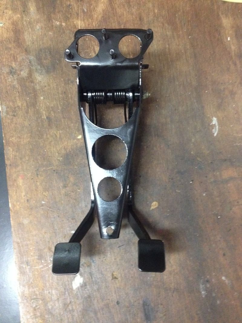

Replacement pedal box powder coated and back together. All greased up. Nice and smooth. Will try and re fit tomorrow.
PostPosted: Sat Apr 11, 2015 1:17 pm
Posts: 860
Hi Hanra,
Do you powder coat the pedals and spring as well?
PostPosted: Sat Apr 11, 2015 2:04 pm
Posts: 6844
Location: Cairns, Nrth QLD
Yep. The whole shebang separately.
