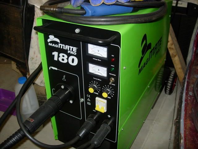

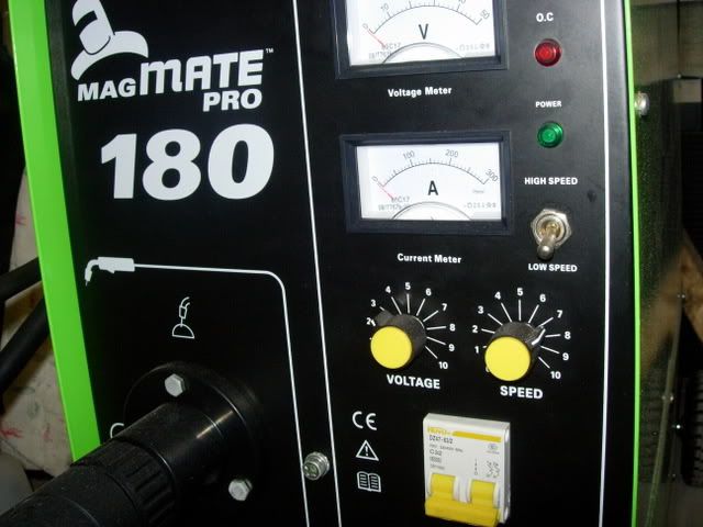

Sure do! Just waiting for some else to set a welder up just like mine :wink:
thegimpy1972 wrote:
Hi just purchased Cigweld 135. Gas and gasless from supercheap for $299 on promo. The unit can get down to 30 odd amps for thin metal. Has 4 amp settings and wire speed adjust.
With any MIG machine, the switch positions are for volts, not amps. Wire feed rate = amps. Double the wire speed, and you (basically) double the amps.
Voltage controls the arc length, and also affects the mode of metal transfer across the arc. Low voltage = `short arc' transfer, high voltage = `spray arc' transfer (if your machine is big enough...) :wink:
The machine holds the set voltage (which is why they are called constant voltage) and varies the output amps to maintain the arc length.
Go down in wire diameter eg from 0.9 to 0.8, and the amps will be less, at the same wire speed.
Clear as mud??? :lol:
Thanks Doc. Not sure about anyone else, but that actually makes sense to me. Cheers!
