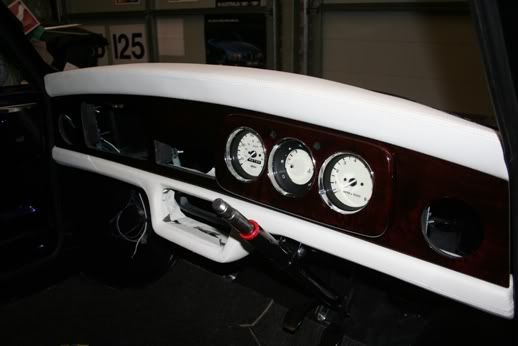

Here's the old dash which I fabricated from MDF and PVC pipe for the dial shrouds and yes, that is velcro for the glovebox.

It sort of fits. I say sort of; top and bottom clearances are pretty snug but there's a 1" gap on the passenger side!

Hi
Your images are not working for me?
I found my dash needed to be trimmed along the top and bottom to make it fit as I had my dash covered with leather , so I agree with a standard dash pads it would be snug. I also had a gap at each end which I adjusted so I ended up with approx 15-20mm at each end.
The gap is not too noticeable if you can make both ends the same
Good luck

As previously advised I also had a gap at each end, which I managed to even up by moving the dash left to right until both about the same. I also sanded off a bit of my dash at top and bottom which may explain why I could move it sideways? I used a belt sander at about a 45 degree angle across the back and kept trying to fit and adjusting until it pressed in between the top and bottom rails.

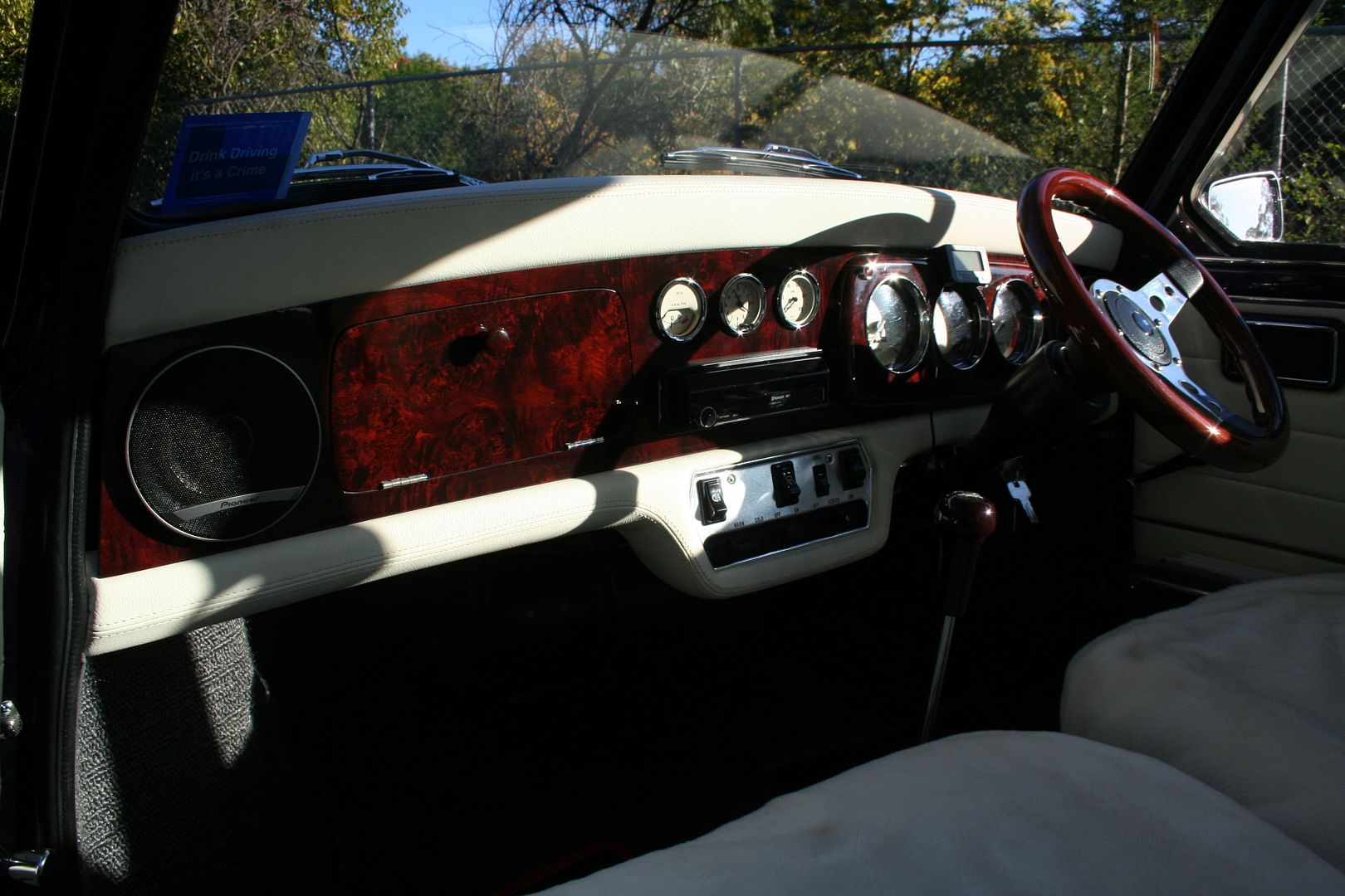

What did you do with your air vent holes?
I only ask since I understand my mini doesn't have any air ducts to hook them up to.

:D I fitted speakers

Here is how I filled the holes. And yes it is a bit hard to hear the radio or music while the car is being driven.
