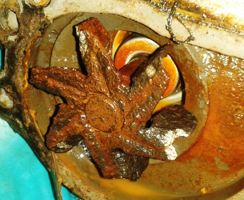

I regard the water pump as a comsumable item. When ever the radiator comes out I spend an extra $40 on a new pump.
Here is a photo of one I pulled off a few months ago. And the car wasn't overheating.
Mine looked like that to but with 3 blades facing the bearing and it wasn't over heating either stuffed if I don't know why
The pump was there for a while as it had the blue paint on it the previous owner sprayed the engine in
I still have the pump to show people who don't believe me when I tell them
