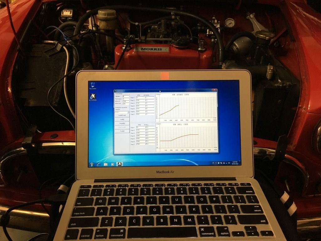

YES!
I still got an error after doing this but when i tried Accuspark it worked. :D :D :D :D :D :D :D :D
Thankyou so much Maelgwn. PM sent. ....thanks also the gimpy1972 for plan B that thankfully i didn't need. :D
Connected to Black box to check and all is well. Happy Days.
Accuspark running on Windows 7 running on a MacBook :P :P :P
