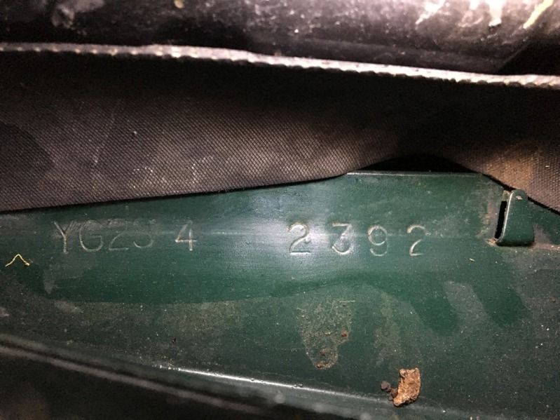

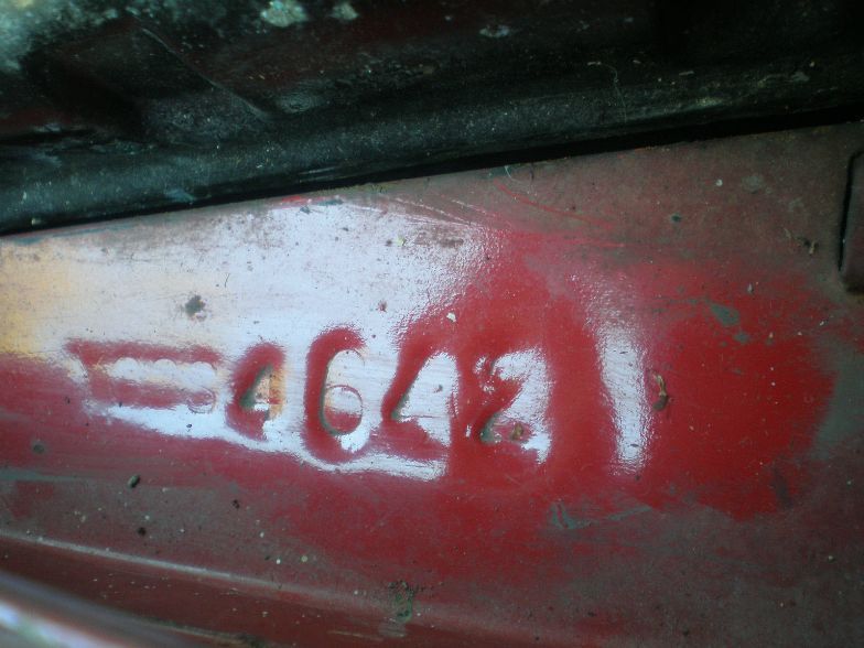

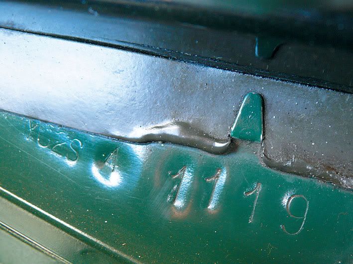

The YG2S is usually one separate stamp and then the 4 is stamped then a space before the car number.
In a perfect world your stamping would look something like this.
The early stampings looked like this
Then this style
Then this style

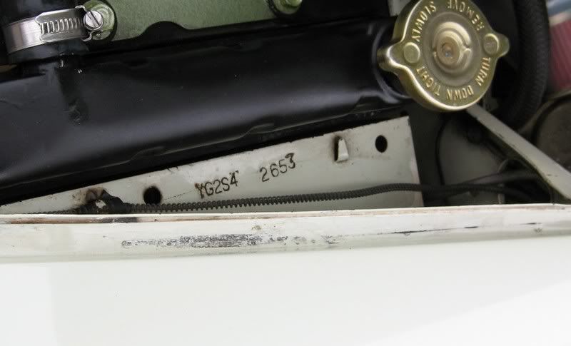

Ive got these pics
I know the white car - a 1 owner and I nearly bought the red 1
Its odd that the stamping is different on sequential cars ?

goxu1 wrote:
Ive got these pics
Looks like the same stamping to me. The YG2S is all one stamp and the others are hand stamped one at a time. The size of the punches at this stage of production are all the same height.
