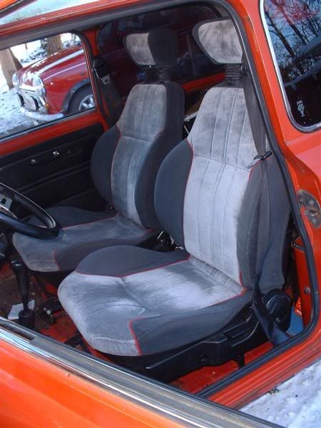

I found the seats out of a 1988 Suzuki Forsa Turbo fit beautifully in my Mini. I just made a couple modifications to them so they would bolt to the stock Mini mounts. This way I can fit them in any Mini or I can swap stock Mini seats back into mine. The Suzuki seats fit quite nicely, they are not as big or as heavy as many other seats I have found. There is room medially for the handbrake and room laterally between the seat and the doors. They also have nice head rests that would be useful in a colission unlike the headrests in a stock Mini seat.
