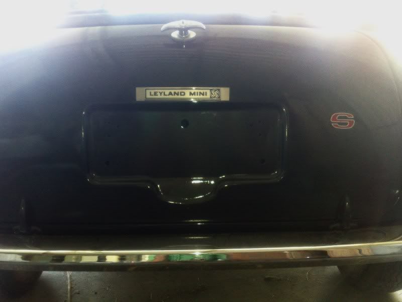

Put the badges back on...
Shiney grill with stainless mesh behind it.
I had a bit of a problem with the rear. My leyland mini badge didn't cover three holes from where the badge from the donor boot went (Mini Clubman badge, or something).. Fix was to trim a piece of stainless steel to use as a backing plate, stuck to boot lid then new holes drilled and badge attached.. Also no holes for the "S" badge so a couple more holes were drilled..
