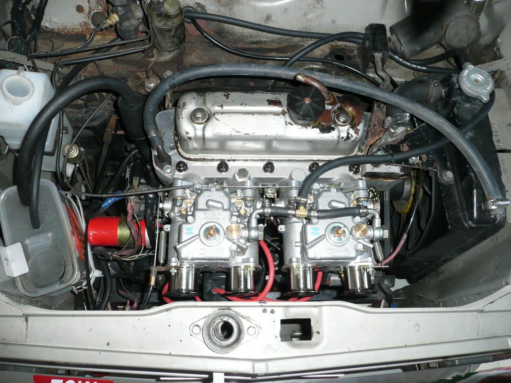

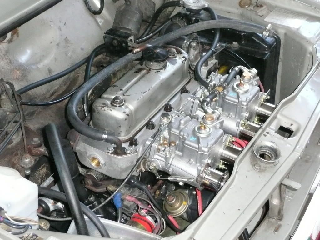

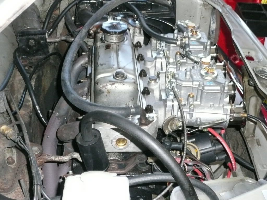

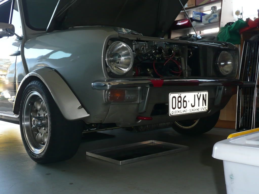

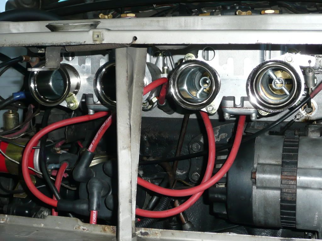

So these are a couple of pics of my dad's car with a pierce 7port head on it. Bought it all assembled with the carb's and linkage kit etc. Had the head machined flat, ports slightly worked around the guide/seat area and general clean up of burrs, casting marks etc. There may be room for a box type air filter setup, but we are just using unifilter socks at the moment. Hope to get some track time at lakeside in the near future to compare with the standard 5 port times.

looks neat! how does it compare to the standard head?

Plugs must be fun to change :shock:
Still want one though.

Great work!
Glad to see another one up and running.
Did a 800km trip to Rylestone and back on weekend - without a hitch. Used a bit of petrol I tell you - particularly the run from Wisemaens Ferry to Lithgow - mostly up hill.
Don't bother changing the plugs , they cost too much! :wink:

Well Meeni, it's considerably better than a standard head (same engine specs etc) lots more torque and power, really gets up and goes now. Revs out a bit nicer too. But i can't really give you a seat of the pants comparison to something. It's just better :D
And yea the spark plugs are a bit painful, i wanted to check what they looked like after i first got it running and was setting up the idle and went for a couple of drives, but that idea went out the window. It seems the plugs aren't the easiest to acquire so my dad went and bought a few spare ones.

Matty, if you look at your 2nd pic you`ll notice that the ram tubes leave a lip inside where they meet the weber body,,, making that section a neat, smooth, Non-stepped transition will improve things
lookin good otherwise tho
