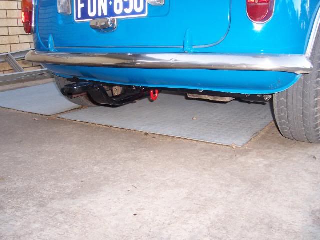

Did a little burn out, got both wheels smoking :twisted: and fitted 16kg of tow bar, tongue, ball and bolts.
Looks good all painted up but these pics are from earlier on.

Here are some better pics of my towbar all painted. 16 high tensile bolts with 2mm thick washers holding it solid to the subframe.
Here you can see the stainless steel heat shield protecting my fuel pump and filter from the muffler that sits right beside them. You can also see the 40mm box pipe welded inside the the rear cross member of the subframe, very strong.
Not really visible with the tongue removed unless your looking for it and the chain shackle doubles as a tow point, that's why it's red.
The lowest point on the car is the muffler at 110mm which after I repositioned it to fit the towbar is higher than it use to be.

I must say, your Mini is a very nice shade of blue. :wink:
