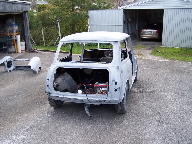

my new fron fits like a glove 8)

cheers, since those pics, all the mounts have been made, and it lines up very schmick, i think im in love :P
bought some absolutely shocking sportspack style flares from minisport, taht were a horrible fit. andrew from minispor informed me of this before i purchased them, they now fit excellent witha few cuts and some fibregglass!
the car is in primer now, and the paint is waiting tehre for me to paint her, hopefully within the week!
the colour is called blood orange! (ba falcon colour) it will also have a black roof and flares , and the rims of mad-mk1, as they arent high enough t fil those uards anymore!
i need to prime the rear flares and the doors today, and then start blocking back teh rest of the car. i shall upload some pics tonight!
