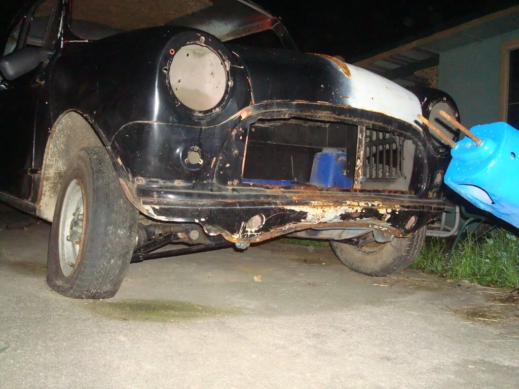

ok, got one of the front apron
this just confuses me more.

OK , that's not the really early front valance so it's between late 1963 (?)and 1968 . Any numbers on the firewall or radiator shroud ?

thought id give this a quick update, bonnet is off, however,
there are no numbers on the radiator shroud, and on the firewall on the drivers side, it has the number 2264 on it, no plate in the engine bay at all either.
what the hell is this car? :?
also, on the bonnet, there are 2 holes a fair distance apart, hopefully the pic i took came up alright so you guys can see what im on about.
<edit> heres the pic

Those holes would be for the Morris Badge.
PostPosted: Sat Jul 26, 2008 8:00 am
Well , if it is an 850 that body number put's it as an early 1961 model which should have the full valance (not the cutout one like in the photo) . Any chance of some photo's of the floor around the shifter hole/s and starter button mound ? Door jambs as Grey64 said as well would help . I'm leaning away from an 850 at this stage from that low body number .
