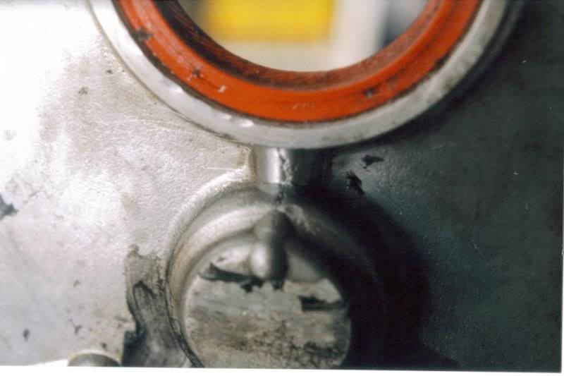

Hanra wrote:
I love this pic!! It just shows the professionalism:
you lost me on that one :oops: :? :? :?
There's a big crack under the silastic if you look hard... :lol:
sitnlo62 wrote:
I am sure no one deliberately starts a job with the intention of doing it badly.
In my opinion I think the above pics disagree with that comment.

I could show a similar picture of the damage to my clutch housing off my old engine. I bought it as fully rebuilt, it ran quite well but always made a grinding noise in third and fourth which I could never trace. I drove it for a year like this until it let go. When it finally went, the primary gear had shredded through the clutch housing, the idler gear had lost 5 teeth and the idler gear bearings disintegrated and filled the gearbox with needle rollers, jamming it in fourth gear.
All because the engine builder hadn't shimmed the primary gear - it had 20 thou of movement.
On the plus side, I threw on another gearbox, clutch and oil pump and she was good for another year, until the headgasket blew and split the sleeves on third and fourth cylinder. Couldn't reuse it after that.

I once took my clutch cover to one of the top engine machine shops here in Adelaide to get the blind end idler and 1st motion shaft spiggot bearing track removed expecting they'd have the proper puller tools to do this. They do a lot of race engines and are supposedly super professional, and are conveniently located at the end of my street.
To my amazement when I picked up the housing I found they had drilled holes through it from the clutch side and belted the old bearings out with a pin punch, then patched the holes back up again.
