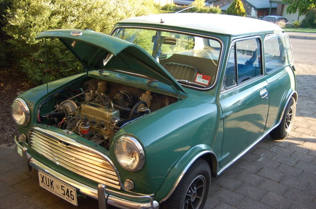

The Twini was all done on a “limited” budget, with minimal flash bits.
Took about 4.5 years and two bodies to get it right.
It has been built as a daily driver, not a performance car, although the potential is now there.
Two similar 1100 cc engines with basic extractors and 1.5 inch carb.
Standard rod change gear box’s.
Standard mini front sub frame in the rear.
Front disk brakes and standard drums on rear.
Modified standard fuel tank, with minimal touring capacity. I have the right hand tank for it, but I am a bit hesitant to cut it up and make it fit around the subframe.
Should be at Mini’s at the Mill with the rest of the family.

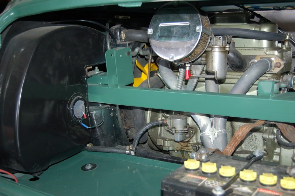

I could only dream of what a 2.2 litre 4WD mini would be like...
Well done, I can't get enough of the pictures. Any chance of an image of how you get the linkages beneath (or around) the rear engine? I'm really curious of how you would manage this feat.

do they both feed intot he one exhaust system? if no. does the back engine exhaust go through it's own muffler? where did you fit it?
PostPosted: Mon Oct 20, 2008 5:08 pm
Posts: 860
Two seperate exhaust systems, one mufler behind the rear engine sideways, and the front mufler is inside an enlarged tunnel between the rear of the front seats and front of the rear engine.

was wondering how the rear engine breathes? or does it manage even with the boot closed?
