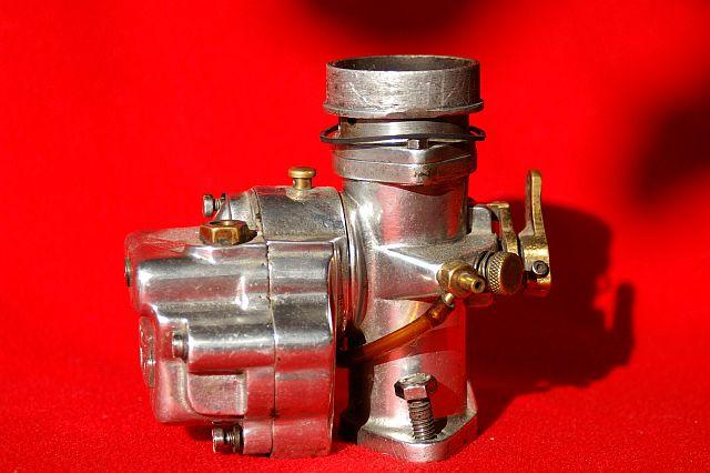

Another very tasty carb (not mine, sadly):
Mikuni flat side carb... Yummy!
Jan
Thats what im talking about!
that very yummy indeed.... ideas... :D
