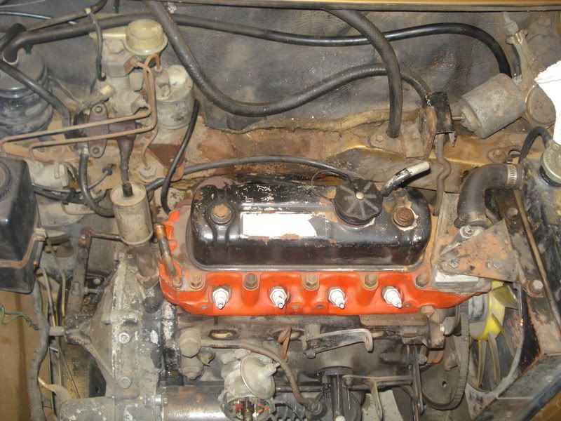

Just to add to the mounting evidence...top one goes to the front on this 50,000k 1275LS (Obviously a "pre-engine fix up" photo...)
PostPosted: Sun Jul 12, 2009 11:08 am
nah,,,, it looks like the top is going to the rear (single outlet on the valve is rear) on that one Mick
& i`m really starting to believe that the top is "Meant" to be to the rear,,, Dad`s 1275LS is also top to the rear & it`s std factory never been stuffed with,,, BUT!!! as the cyl bore sizes are the same top & bottom,,, the only reason i can see why the top should be rear is for that fluide level thing that Deluxe-68 mentioned.

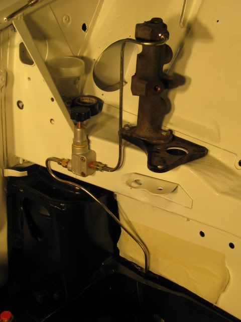

PostPosted: Sun Jul 12, 2009 10:18 pm
Check it out!!!!
Me = HAPPY!!!

Very nice, William. What are those Wilwood valves worth?? :P
PostPosted: Sun Jul 12, 2009 10:27 pm
Most shops sell for around the $130.00 mark.
I paid a bit over $100 for mine... its good to have contacts :D

Looks very nice, good to see you didn't use that teflon coated pipe. The plating is better to look at 8)
