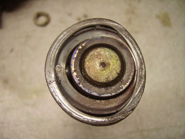

Clutch arm Perfect and so were the Pin's
so I took off the Wok to check the bearing. My Original thou was confirmed. No wonder it sounded noisy what the clutch peddle was pressed. So what I think has happened is th bearing was giving way and with the addition force required to press the clutch in the slave piston has broken the clip and then let the piston out
Thinking a bit more about the pic of your first class bearing here, I'd also suggest checking the thrust plate on the diaphram for scuffing. It could be that the wok is off centre to the centre line of the crank.
If you suspect that this is the case, probably the easiest fix with the engine in the car is to make the bearing a 'floater' as Leyland did from about 1975.
