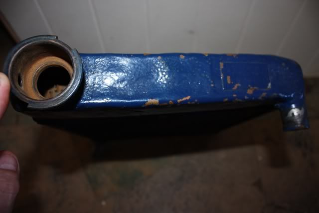

Well this is not so much of a mystery. just a discovery.
I am guessing that this is the standard radiator, correct??
It is painted the same colour as the engine, so i guess that it was reused after the engine swap then swapped it to a different one for an unknown reason.
So do you think its worth restoring it and putting it back in. They are becoming reasonably rare now i would assume. We have a radiator repair place we use at work, so i'm sure it wouldn't be too much of a big deal to fix it. Depends what was wrong i guess.

Its an early radiator. The top hose inlet to the radiator is spaced further forward than the later types. No different really to the later radiators unless you are after something particular, and like you said, no harder to fix.
