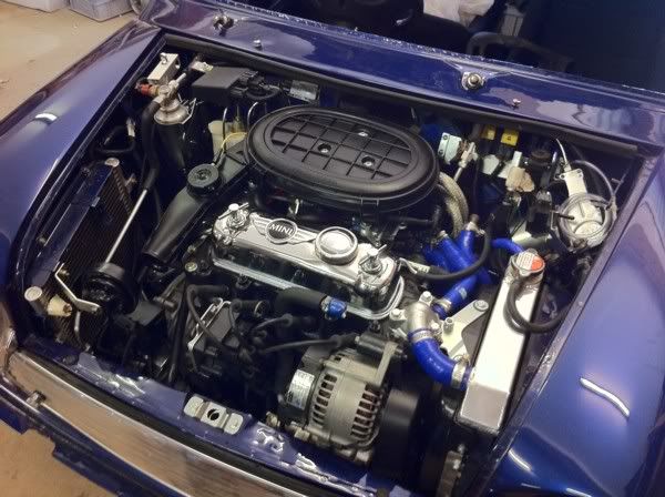

As I still have all the Catlogues/Books and contacts with A/C part suppliers agents that I deal with you are welcome to come and have a look at the Many sizes and configurations of condensers in them and if need be I can order you one. Another option would be to go to a wrecking yard with a measuring tape and measure a few and perhaps you can find one that suits that way. But remember any condenser will need it's own Fan to draw air through it so remember to allow for depth. Also (on Minis) air sucked through the condenser will need it's own exit and must not flow out through the radiator as that will add super heat to the already hot radiator. Good luck

Hi Nick,
I see that you having some temp issues due to air/con.
After I finish my power steering project (which is soon, before 13/02/2011)
I am looking in to a alternative (12V fully electric) air con option for Mini’s not belt driven at all. You can even run air/con when car is not running.
I know some people will say why, you don’t need air/con, if cooling system okey you should not have any issues.
My answer is why not.
I do not have any temperature issues but engine bay is very full. Hard to work and when I go to shows not as presentable as much as I want.
Where is going to be placed you may ask well either under the rear seat or the boot. In your case (people with vans you can place behind the seat)
Anyways, if any one thought of this before or even done I would welcome their input, please share with us.

you could run a front mount rad & where the old side rad sat sit a condensor there?

This is the factory setup, and I think it would be very hard to improve on.
Putting compressors and condensers in the boot could be done sure, but where you stash your tools if you have a second engine compartment in the back? :lol:

Had a measure in a mini engine bay today, and agree with Harley. The factory set up with the condenser at the side would be hard to better, and I think that is where we'd end up anyway. What are the dimensions of the condenser Harley ? Do you have a part number and supplier?
Nick, at the moment I'm building a mini very slowly and air conditioning is on the wish list. I'll post full details of my system when it's finished.
