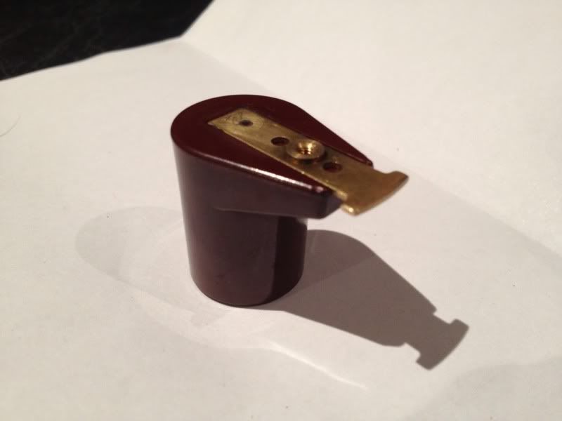

Another arv spent dicking around with this heap of sh*t... Fitted points, changed back to a GT40 coil, confirmed continuity of all wiring, confirm condensor ok, confirm points clean and making and breaking.
Inductive timing light fitted shows no spark at all, 12v at coil during cranking, confirm continuity of HT lead, brand new dizzy cap fitted. Brand new rotor button fitted about 6mths ago... No spark... WTF...
Disconnected the tacho from the neg side of coil incase it had failed... nothing...
Fitted another grubby ol rotor button... bang off she goes... I never ever thought to even check continuity of the rotor button, as it was brand new... have never had one fail... Sure as SH*T its friggin open circut....
Its probably done all of about 20klms... Bosch GL256

Its still beyond me how this button is U/S... It's identical to the grubby old one I fitted. But 100% proven that it is U/S and causing no spark. Perhaps a hairline fracture that is causing it to be O/C????
Dunno but I'm over it... Prob won't drive it till next year!!!

Its still beyond me how this button is U/S... It's identical to the grubby old one I fitted. But 100% proven that it is U/S and causing no spark. Must be a hairline fracture that is causing it to be O/C??

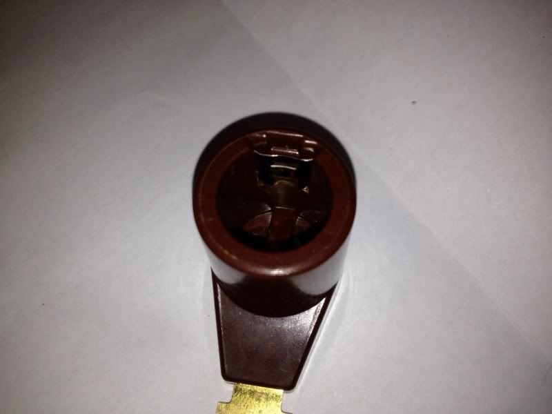

Should point out to that whilst fault finding, I've fitted a brand new dizzy cap: GL278, new points: GL19 and this GL256 rotor button which was practically new....
I would have anticipated that the HT could jump across a fracture... I can't understand how this rotor button causes no spark... I'm still dazed and confused... As I said, its identical to the grubby old one that allows the car to run!!! Fit this one, she dead... Wrapped in plastic.

Hanra wrote:
. I can't understand how this rotor button causes no spark... .
Its obviopusly stuffed , as you have said , you should try cutting it open to see why it is stuffed .

goodie wrote:
Should try jumping a spark through it and see what happens. :wink:

Hairline crack would not prevent a spark, after all the spark jumps from the end of the rotor to the spark plug lead terminal. My suspicion is a short circuit inside the plastic moulding shorting out to the spring tensioner that keeps it located on the distributor post, and hence diverting all sparks to ground through the distributor shaft.

The one and only time I lubricated an early distributor left me with a short cct on the rotor button. The oil soaked into the bakelite and created a path to ground.
