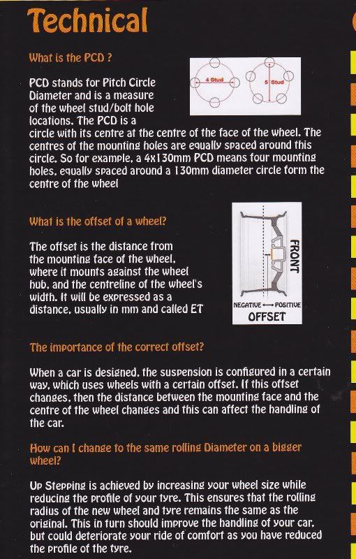

Here is what Midland's sent me. It confirms what smac quotes, but I finished up with 'sticky outty' wheels. And my tape measure still reads 100mm from disc face to outer rim. The only problem you may strike is rubbing on the front wing on lock, if lower than standard.
