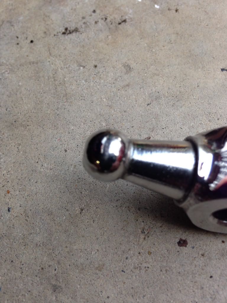

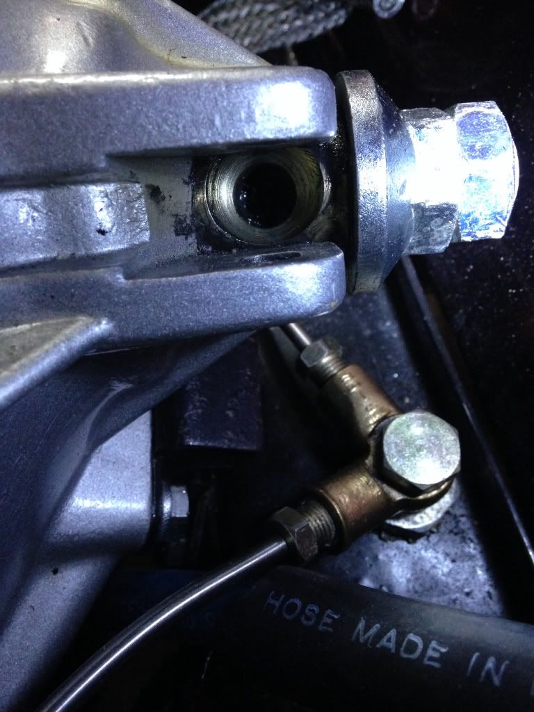

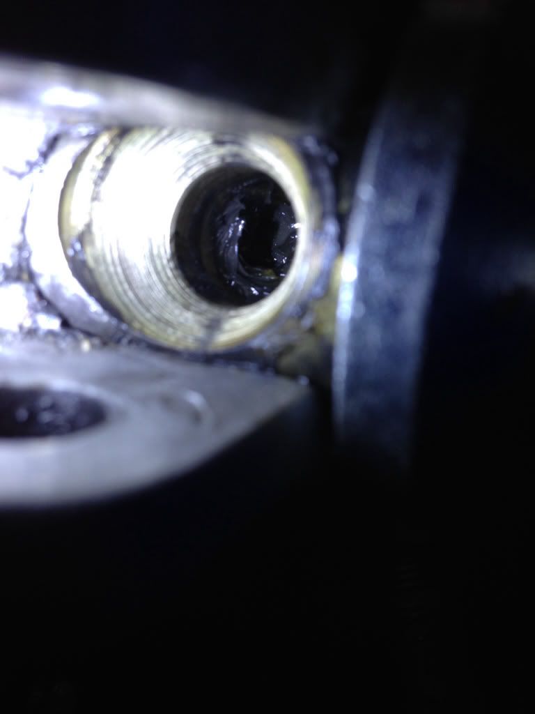

PostPosted: Sun Mar 02, 2014 8:57 pm
Posts: 3166
So! I removed the clutch arm this evening and it looks OK, maybe no wear cause I had the new arm chrome plated :roll:
I am also trying to add photos from iPad , so not sure if this will work?
I then took a few photos of the inside of the bearing carrier
Which also looks ok with virtually no wear. I also checked the inside by running a small screw driver up and down the inside where the ball would press against the carrier and could not feel any indentation
So I think all is ok on the outside.
I have put it all back together and adjusted correctly so will now take for a test drive when the rain stops :)
