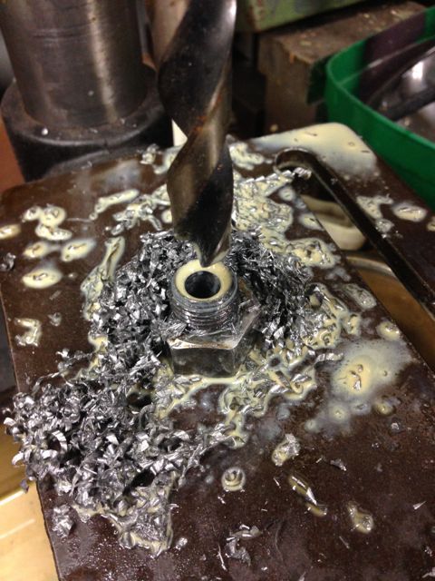

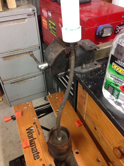

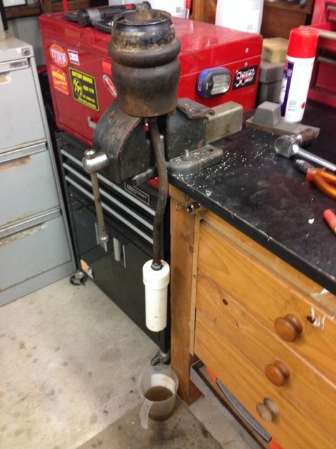

Big thanks to Don for his research and suggestions. I need to replace a bag on my car so followed Dons suggestions and made up a funnel to clean out a spare for replacement.
I bought a bunch of 5/8 UNF bolts and drilled them out as suggested. I used a piece of 2in PVC pipe and an end cap. I simply put the drilled bolt thru the end cap and used a nut to hold it in place, rubber washer forms a seal. Worked a treat and washed out 3 bags. I have extra nuts that will be countersunk on the end to use as caps once I fill the bags with hydro fluid for storage.

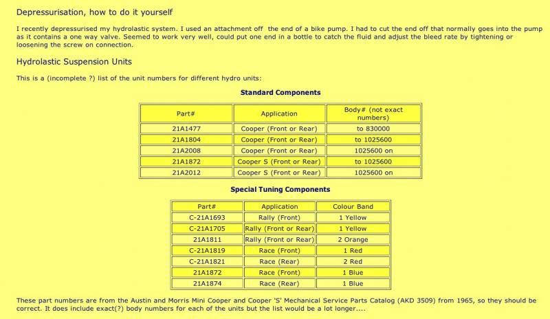

willy, if the bags don't have too much rust and/or paint over the side stamping, the numbers should be readable with date and 21A_ _ _ _. Thats the only way I know of, that is until I figure out a tool to open them up without damaging the seals to re-crimp... I can't recall where I grabbed the below pic from, but it was somewhere out there on the inter-web machine.
Image Copyright by: Someone awesome!!! (thank you for putting it online)
Morris 1100; Yes and no, I have had success re-crimping the bags with a stainless ferrule... Provided as long as its' only one side of the line. There is just enough old line to cut above the old crimp and re-crimp with enough length to reach the connections. Not sure if the line would reach if I had to re-crimp both sides. I have not had time to purchase and test a flex line and ferrule combo to replace the old flex lines, but there are several manufacturers out there with sizes that would work. No manufacturer I've found makes a herringbone look line that will perform at the pressures needed. That would probably be a custom make, requiring a minimum order of meters in the hundreds, if not thousand. Anything is capable, with my skills and someones' $$$!
