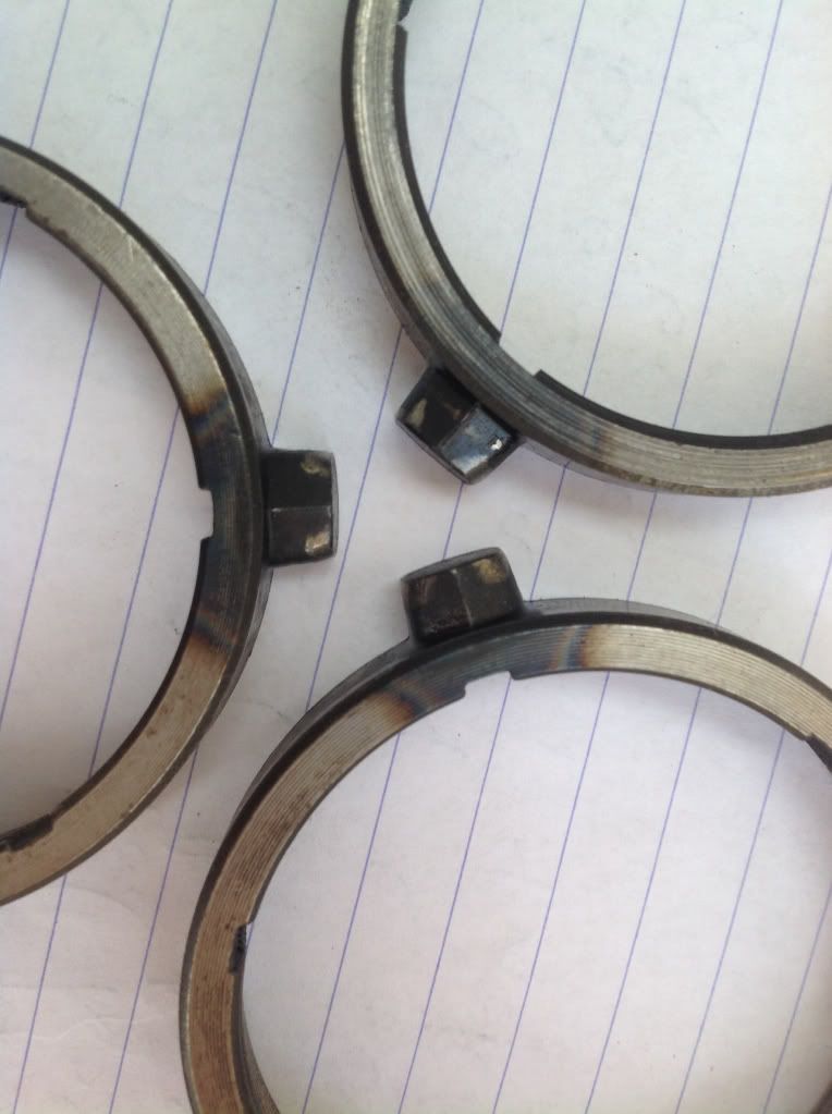

Everything I read so far on rebuilding gearboxes suggest replacing the Baulk Rings, they are cheap enough so it's not an issue but is this because of heat stress rather than wear?
Do these look normal for a used gearbox?
The heat marks are where the 3 ears are hardened. If they weren't the baulk rings wouldn't last 5 mins.
To see how worn they are, sit them on the gear and measure the gap. New ones are around .040".
Some folks me included surface grind or linish .020" off that flat face, this gives them extra life.
If buying new ones, try them on a gear, they should not rock about. If they do, buy elsewhere.
