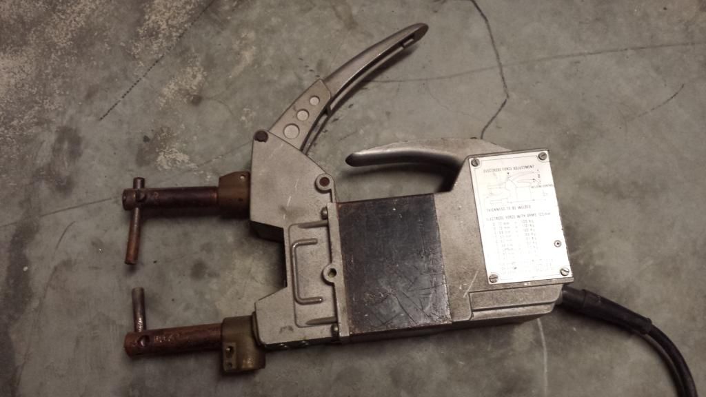

What is the go with your spot welder, home made or bought?
It's easy once you know how.
PostPosted: Mon Jun 02, 2014 10:41 pm
I've had the spot welder for a few years now. A fellow up Tenterfield way was getting out of the garage business, and had a number of Mini bits e offered to me. In amongst them was the spot welder. Greatest thing ever when changing panels IMHO.
You can do a half spot just to tack it in place, then if you like it you give it a full shot. Otherwise just wriggle it off.
Pretty useful, it does the rounds :)

Mmmmmmm, does it have longer arms to go on?
PostPosted: Tue Jun 03, 2014 11:09 am
I made a set up once from steel, but had too many problems with the pressure applied at length, and the loss of current voltage along the bars. With the long bars, it's a very low voltage divided by a very low ohm to allow the high current. Add the bars and only a few milliohms of difference makes a really large reduction in current, and hence the outcome. I use plug welds for distant spot welds. Not much problem for standard external panel replacements however.
