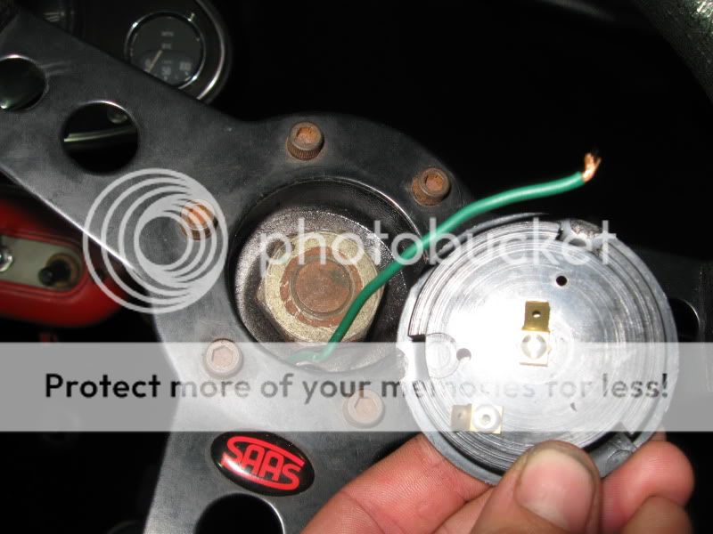

Having discovered that the horn button isn't fully connected, I set about trying to get the steering wheel off to have a crack at hooking it back up. Only to discover that I don't have a socket big enough to get onto the nut. :x Return that job to the backburner.

The Duckmeister wrote:
Having discovered that the horn button isn't fully connected, I set about trying to get the steering wheel off to have a crack at hooking it back up. Only to discover that I don't have a socket big enough to get onto the nut..
I know this is a little dodgy but a common method with the nut is to drill the beginning of a hole in the top of the nut near the edge then use a drift/punch/old screwdriver and hammer at an angle to loosen it. Someone has done this with my nut but I'm lucky as I have the right socket.
PostPosted: Fri Apr 22, 2011 7:09 pm
Most horn problems can be fixed without removing the wheel.
It is usually the contact on the blinker switch to the column that is the problem.
Not in this instance. I popped the button off to find no wires connected to it! And only one wire mounted to the hub of the wheel. It definitely has to come off this time. I'll chase out a socket tomorrow, & if that fails I'll try the method suggested by phillb.
PostPosted: Fri Apr 22, 2011 7:31 pm
There is only one wire and it sits in the end of the column. The horn button just earths that wire to the column to complete the circuit.
If you short the contact on the blinker switch to earth does the horn blow?
PostPosted: Fri Apr 22, 2011 7:40 pm
Posts: 782
A few times when was able to drive it on an unreg. permit (currently not roadied or registered. :( ) I found that it would very briefly "chirp" if I had to manually cancel the indicator from a right turn. Never got a noise from actually pressing the button.
I haven't investigated around the blinker switch yet, I'll have a poke around tomorrow.
And if there is only one wire, where does the second terminal on the back of the button assembly connect to in order to complete the circuit? Does it just rest against the tip of the steering column?
PostPosted: Fri Apr 22, 2011 7:46 pm
Posts: 39764
It rests inside the steering wheel, and earths to the metal hub inside it.
PostPosted: Fri Apr 22, 2011 8:00 pm
Posts: 782
Thanks M1100 & Doc. :)
The offending bits:
So if I connect that wire to the terminal near the edge of the button assembly, the other terminal should rest on the hub of the column?

PostPosted: Fri Apr 22, 2011 8:09 pm
It is never going to work! That is a later column which has the horn on the end of the blinker arm.

PostPosted: Fri Apr 22, 2011 8:26 pm
Posts: 782
Well I would never have discovered that by myself!! Thanks heaps. Just went out to check, and whaddya know, it works! :)
