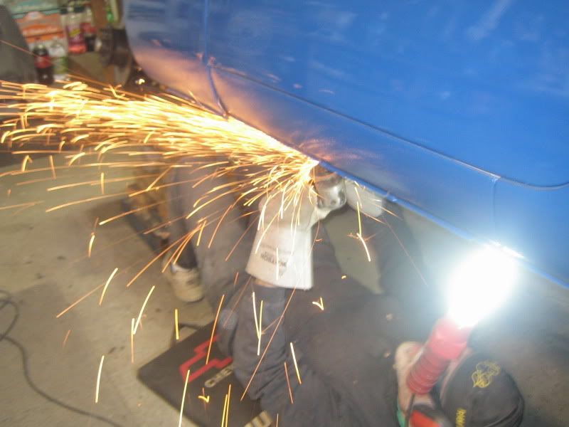

Work on the MGB moves along. Replaced the castle rail on the LH side and related membrane and floor/sill repair with new steel. After sound deadening removed, floors acid treated, etch primer and seam seal. Also etch primed and seam sealed the engine bay after acid wash. Next fresh paint in the engine bay and reassembly can follow.
