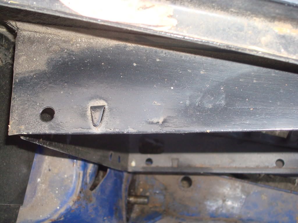

for starters, the starter button hole, why do i have 2??

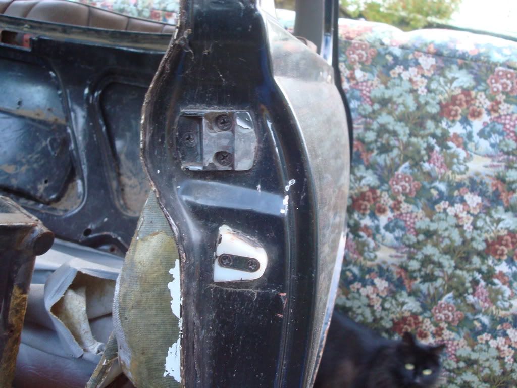

door strikers

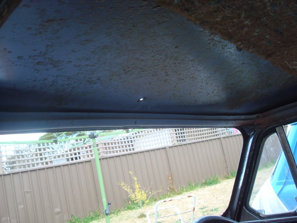

lack of sunvisor holes
headlining holes

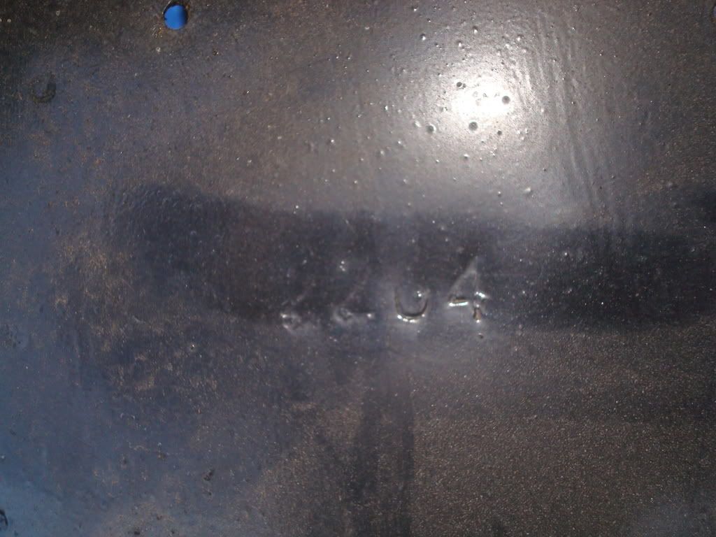

"rubbed out" radiator shroud

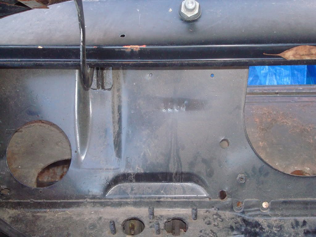

firewall

minidrifter wrote:
pics have arrived,
The starter "button" (switch) is back right beside the gearshift....those are subframe mounting holes.
The plate top left (4 self tappers) is covering the original 850 "pudding stirrer" gearchange.

minidrifter wrote:
headlining holes
The top one (through the roof) is either a radio aerial mounting or maybe for a roof rack crudely bolted to the roof.

Yep the push start is further back and those holes are for the Subby
Door Strike looks looks like itrs been out of Alieanment for a long time
hate to think that some one would put a areial or a Roof rack thier but hay many have done scarier things (get some one who knows how to weld here to fix it
Get a got grinder and a Twist lock wire wheel (if you want Pic's I'll gladly show you what works well) to find what is hiding under paint on the shroude and fire wall and anywhere else you want to find holes

my guess, that was an aerial that was poking through the top,
so the starter button would be up near where that metal plate with the 4 self tappers would be? i have no idea, ive never ever seen one before.
so gaf, you reckon if i use a twist lock wire wheel to take away some of the paint, that'll reveal the other numbers, i dont wanna go nuts with it just yet, i dont wanna find anymore holes, i mean, im already lost with the bloody subframe mounting holes as it is :lol:

the starter button would be back near the cross member offset to the driver side
try some paint stripper on the shroud as the wire wheel will take out any lightly stamped numbers the stamping was not always the best
