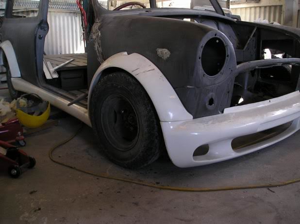

PostPosted: Sat Apr 02, 2005 3:35 pm
Posts: 1461
I got the front rubber cones and the cone struts out and left it at that. I left
the cones and struts out and let the car down on the bumpstops, Now the
van is sitting a little less than an inch from the ground. All i have to do is get
the rubbers apart from the strut and replace the strut with a hi - los and there
is the front done..
Life's a garden.... Dig It!
PostPosted: Sat Apr 02, 2005 3:45 pm
Posts: 1461
This is the hieght of the car with the cones in..
This is the hieght of the car with the cone out..
PostPosted: Sat Apr 02, 2005 11:39 pm
Joined: Sat Jun 05, 2004 11:59 pm
Posts: 1089
Location: Southwest WA
noice body kit there Gordo.... :P Love that front spoiler.. they dont do one for a clubby do they?

PostPosted: Sun Apr 03, 2005 4:01 pm
Posts: 1461
They do, do a kit for the clubby but the front spoiler is a little different,
and a bit more expensive... And personaly i like the look of the round
nose front spoiler better than the clubman one.
