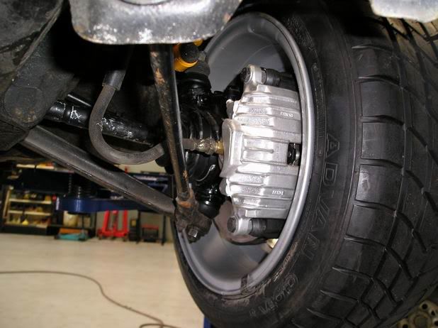

13secmini wrote:
honda city conversion for 10inch wheels:
[/img]
In Dunlops :shock: Will they... :? Any good

These are Camira brake conversion.... 9.2" vented

all these conversions using the drum hub , do you put disc cv's and bearings in?
Disc CVs are used in the Camiras but not the Hondas. So Camira setup is stronger if you're gonna fang it real hard. :P
Disc bearings (Timken tapered rollers) will fit either setup. I don't buy the angular contact ball type any more- they wear out faster than the rollers and are less strong. :wink:

OK then, suppose I have an all drum mini, and I want to purchase all this stuff new to go to camira's. What do I need?
1. Calipers
2. Pads
3. Rotars
4. Mini Disc type CV?? (what bit is this exactly?)
Also, what happens with the rotars, I assume using current bolt holes a spacer is bolted on that has its own pcd?

i picked my camira setup up from the engineers today, the only way he'd approve them if the caliper bracket was more than 8mm ( mine was 10 anyway), and the cooper S flange was stepped into the spacer.. like a standard S rotor setup..
took them around to my apprentice fitter and turner mate this arvo, hes gonna knock the whole setup up for me for a carton, over the next week or so..
8) ill get pics, measurements.. everything you could possibly need and put them in the mods section when everything is sorted out..
:wink:
(i made the spacer, and caliper bracket from MDF) much easiler to cut and drill 8)
