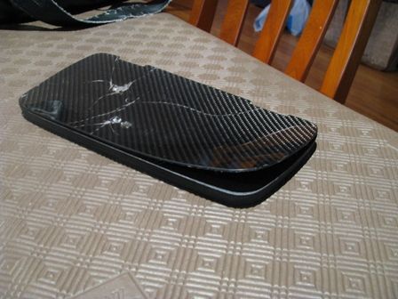

My UK carbon fibre (effect) dash obviously doesn't like the
aussie heat. It started delaminating and that carbon fibre laminate, once curled doesn't like being clamped back down it fractures. Disregard the big star cracks in the picture, that was me after deciding it couldn't be saved and tried to slice it off with a flat knife, but it was also very brittle.
